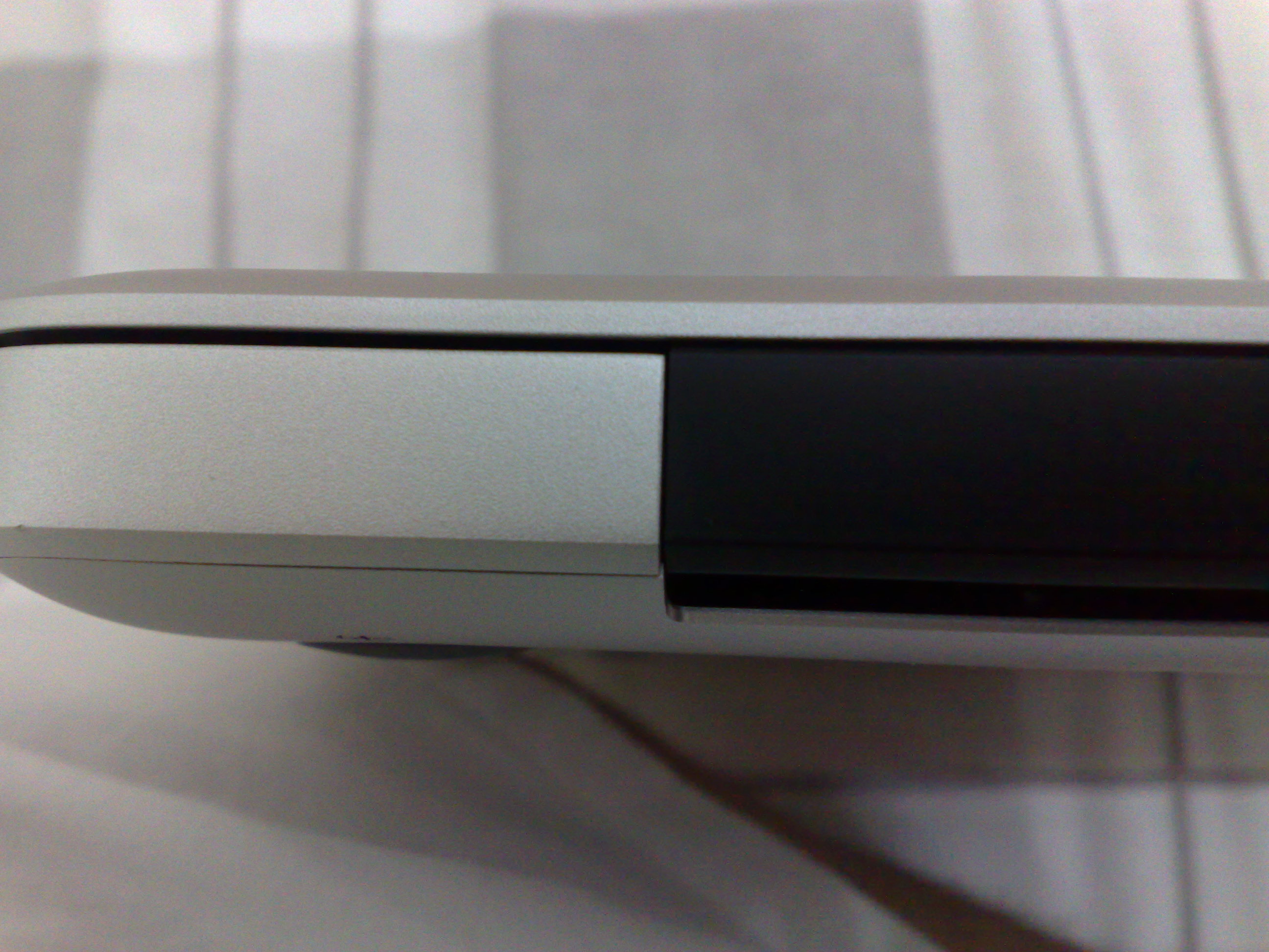

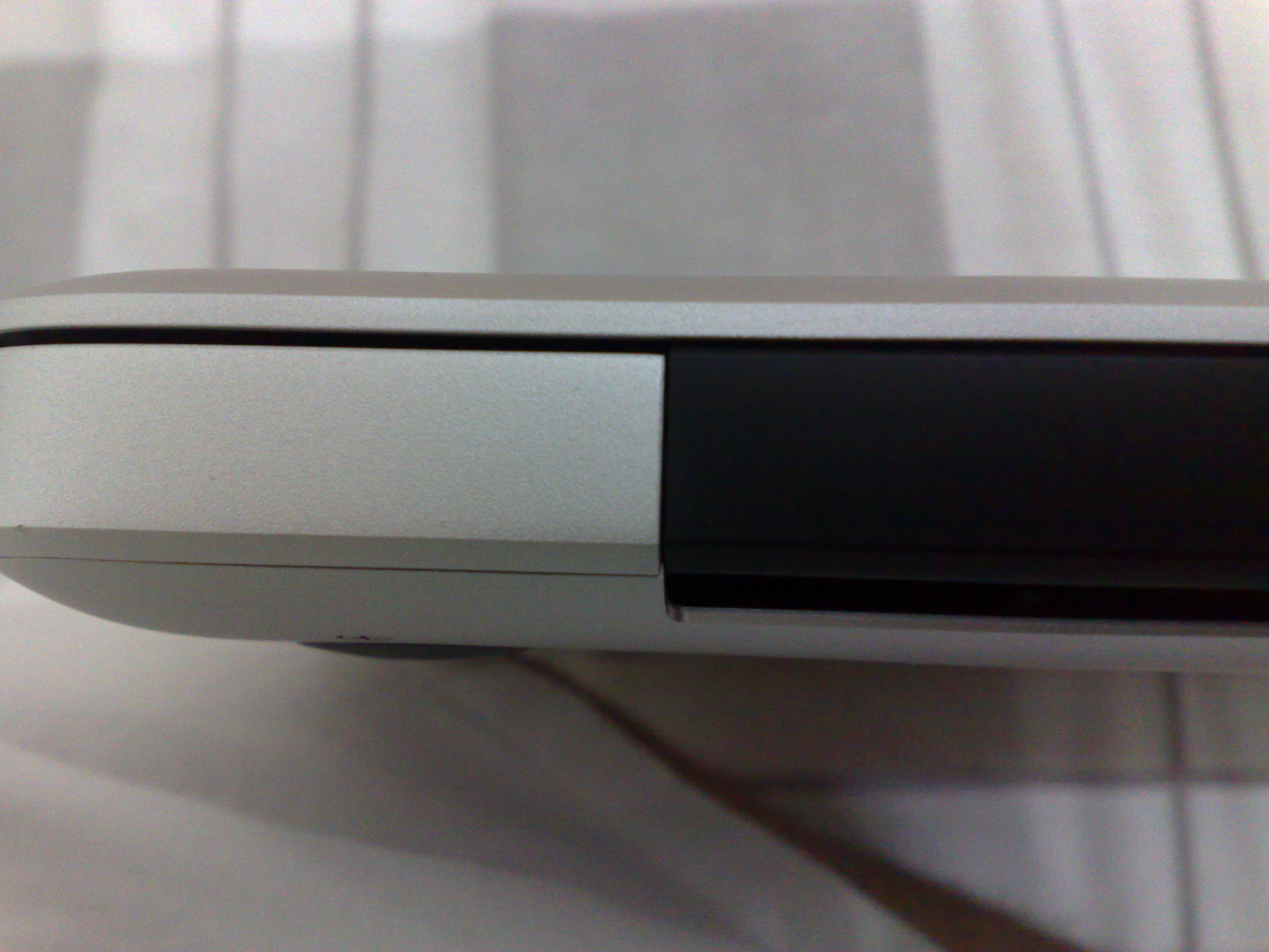

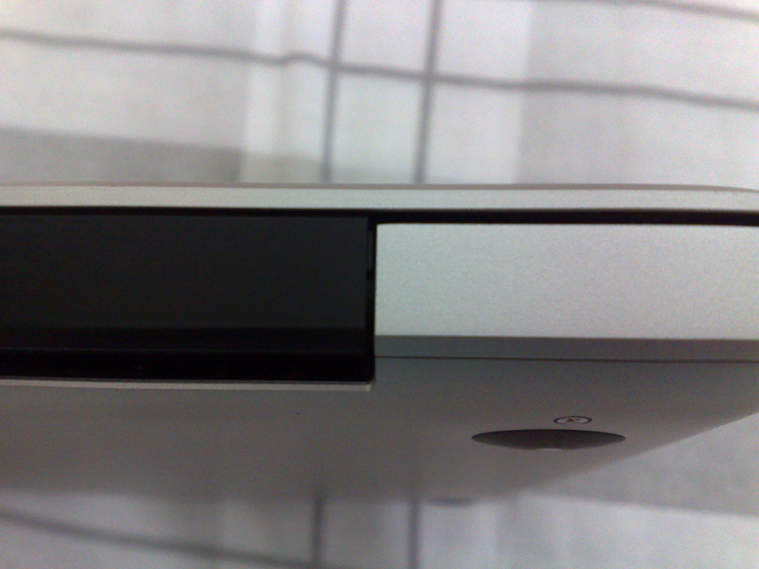

These 2 pictures (sorry for quality, taken on a n95) show the misalignment on my uMB. The left side is a lot closer to the aluminum than the right side is, and I believe this is the cause of the noise.
is it covered by the warranty? Should I take it to Apple?
To be honest, I think they'd most likely laugh at you and call it a "User perception issue"
