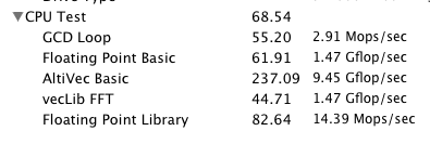

Some friend asked me for two 1.8 CPU's, and i have exact 2 1.8 that are working. And a 2.0 that is also working. So i thought i put the 2.0 in my 1.8 machine. It works, it is recognized as 2.0 but i noticed while benchmarking, that the speed goes up and down.
This is a Xbench of the 1.8 and that is very constant:

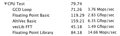

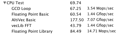

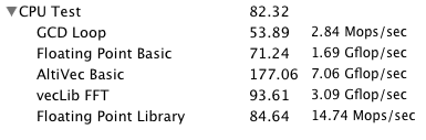

This is 3 times the 2.0:
As seen it is some kind of rotating. Running something like Cinebench is slower than on the 1.8
