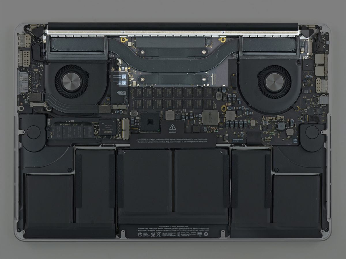

Okay, so, all it is, are metal springs that are part of the logic board that are pressing against the backplate when you press on it. it is NORMAL, and about 75% of macbook's have this.
Also, it is fixable, by trial and error, via removing the backplate and rotating the springs (don't ask me why this fixes it, but it does, sometimes).
The noise comes from the metal heat sink as its directly below the thin cover, just the way the design is on these machines.
