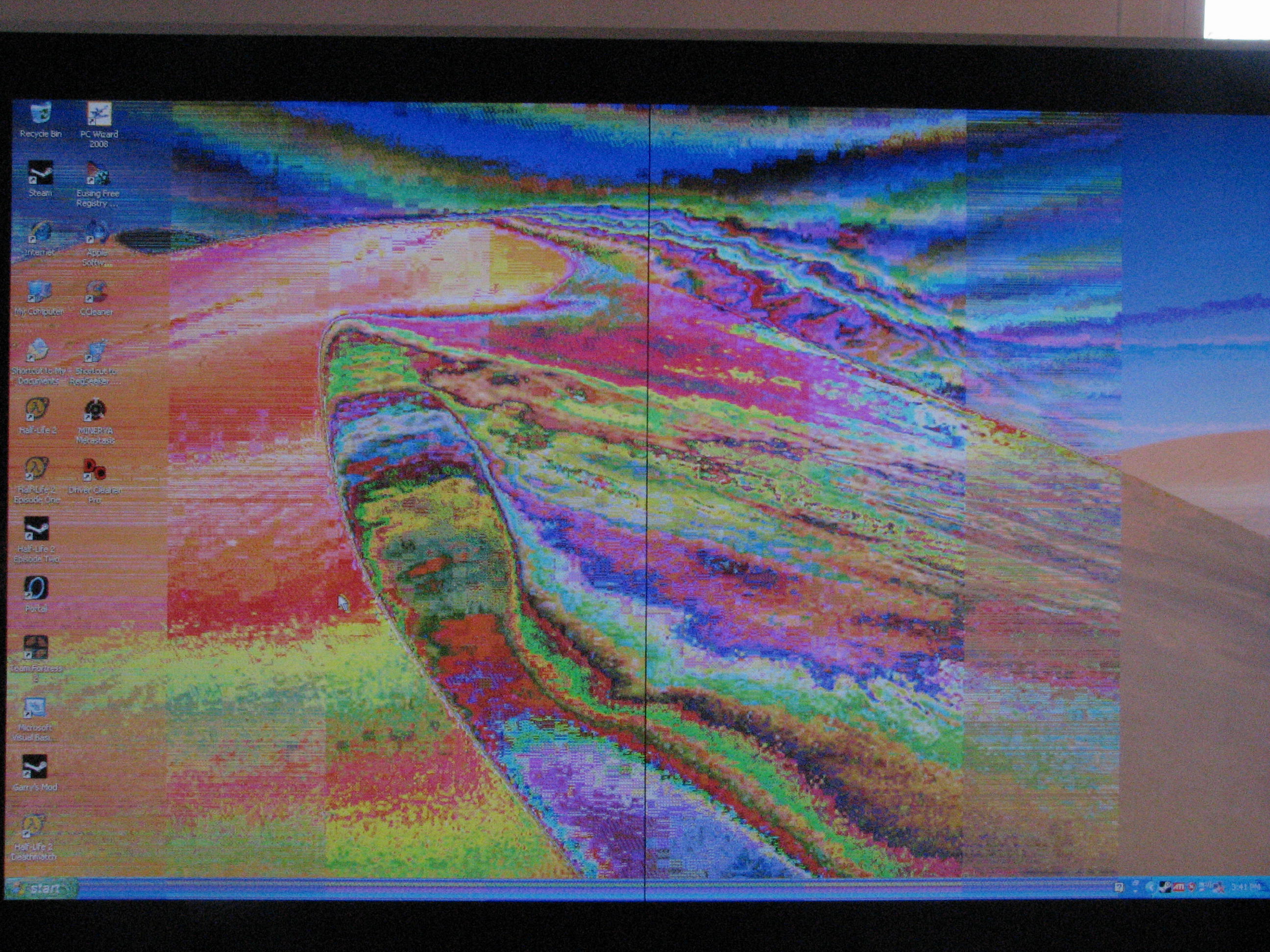

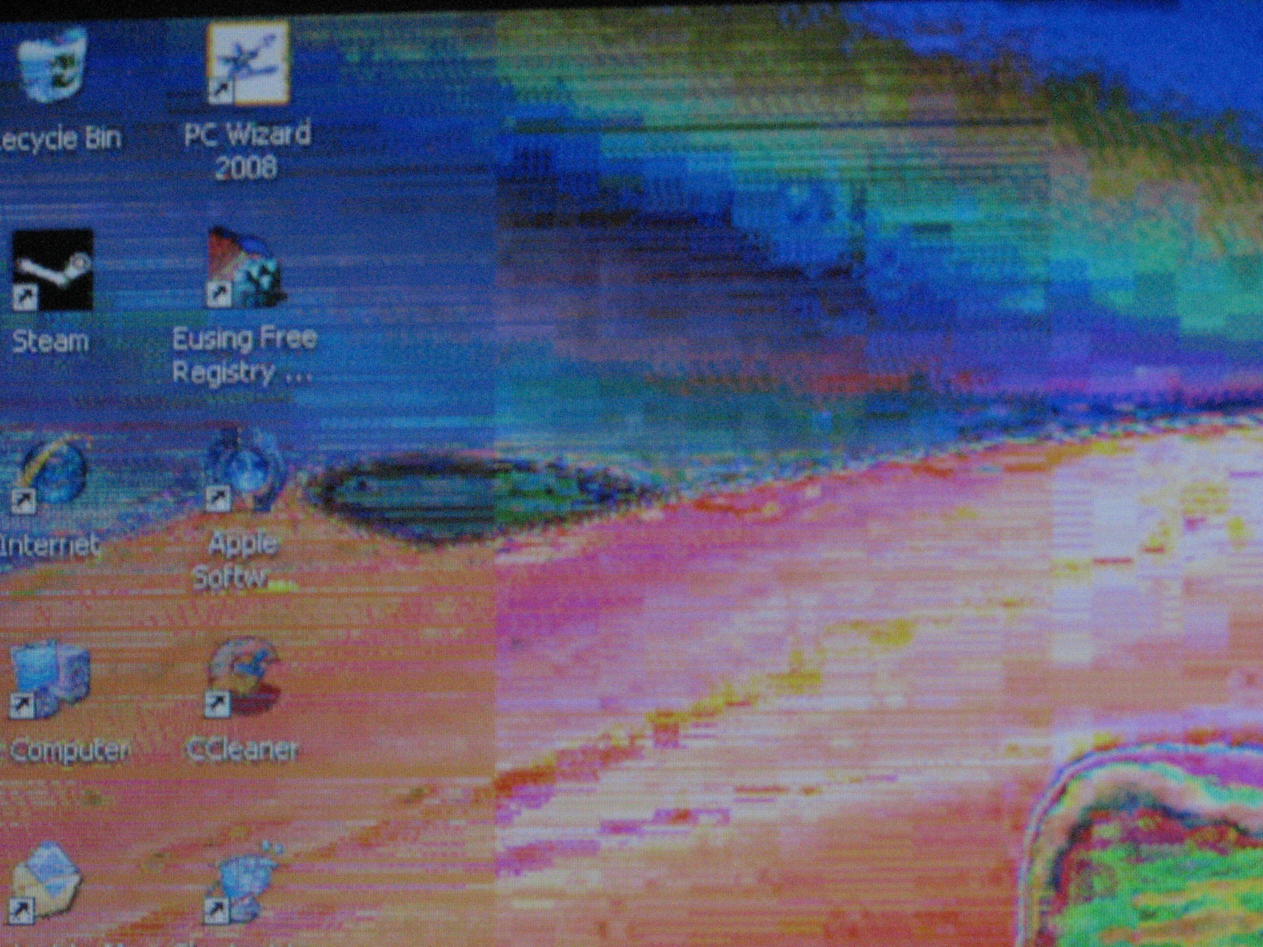

I've got a refurbished 20" 2.4 GHz Aluminum iMac, 1 gig of RAM, and the Ati radeon hd 2600... well mobility xt or pro or whatever we've decided it is...
Anyways, I've installed windows xp sp2, updated it fully, and succesfully installed all the Boot Camp 2.0 Drivers, but i'm getting a very strange display problem if I leave windows on for a while, I'll attach some photos to explain. BTW: I had to take the photos with a digital camera because when I tried taking a screenshot it showed up normal when I rebooted... I don't know if that means anything or not.
I'm also getting strange graphical glithces in games like half-life 2 and Team Fortress 2, like strange colors on textures and my flashlight sometimes becomes a square pattern. I also got a BSOD message in GMod today, STOP: 0X0A, I have the whole message if someone could tell me how to track the number down in regedit or something. I've tried everything, like updating the drivers using both Mobilty Modifier and the omega drivers. I'm currently using the newest ones from AMD for the 2007 imacs, version 8.43. Anyone have any ideas???
P.S. I haven't noticed any problems in OSX, so i'm fairly sure it's not a hardware problem...

A lot of times graphics glitches are heat, but yeah.. your icons look fine so it's kind of hard to tell. 😕
Well nevermind, only the center of the screen is messed up, didn't see that at first. Could still be some sort of heat issue... run a program that looks at internal temperature and see if anything looks high.. or maybe play games for a while and boot into OS X quick and look at the temperatures.

I am pretty sure it's not heat, cuz it just does the crazy color thing at random times, not when it's under stress, like i've had me logged off and left it on for a night and when I woke up it was crazy colors, and it actually is screwed up on the sides, just not as bad... I'm pretty sure it's some driver error or something, anyone know any program that could check if i have any drivers on my computer that is screwing it up??? And i'm still wondering if Device manager shows 3 default monitors, 1 Generic Television, and 1 Plug-and-Play Monitor for everyone else...

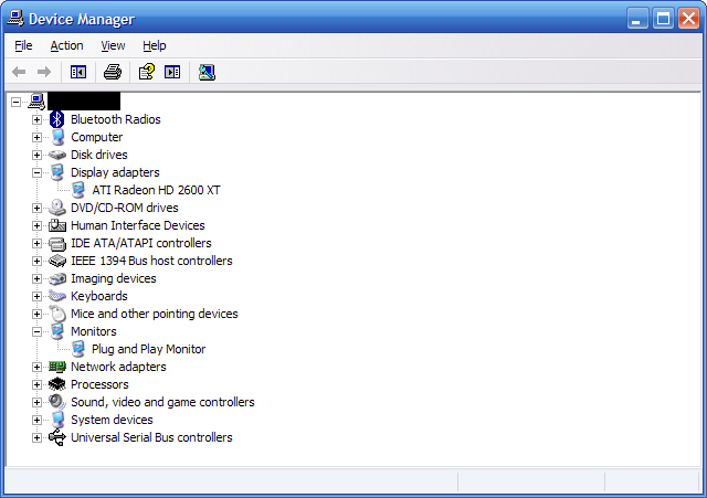

In Device Manager, I have ATI RADEON HD 2600 XT listed under Display Adapters and Plug and Play Monitor listed under Monitors. No generic televisions or the like.
I think some of your drivers might be messed up or something like that. Try to reinstall the drivers from the Mac OS X Leopard disc and hopefully that helps.
Hmm... I tried uninstalling the monitors from the Device Manager, but when i rebooted they just came back, so i disabled them and they're still disabled when i reboot, so i'll let it run tonight and see if it goes crazy again. I also installed smcFanControl in Mac OSX and i think when i rebooted the fans kept going, so hopefully that helps too, i checked PC Wizard 2008 and it said none of my fans are going at all, but I think it just can't read them or something cuz it's the iMac...

And if you click on the Plug and Play Monitor in Device manager and go to Details does it say DISPLAY\APP9C6A\5&2E5008AE&1&10000081&01&00 for Device Instance ID...
It'd be really nice if there were some screenshots somewhere of the device manager in a 20" aluminum 2.4 iMac running Windows XP (without any problems), just so I could compare...

Here's my device manager if it helps.
NOTE: I manually updated the graphics drivers myself. They originally said Mobility Radeon HD 2600 XT.
May have solved!!! Probably not, haha, but my device manager looks a lot different now.... Like all the monitors are yellow ?s, but maybe it will be all right, If I go through tomorrow without any problems I'll post how I did it... but for now I have to go to bed...😀
