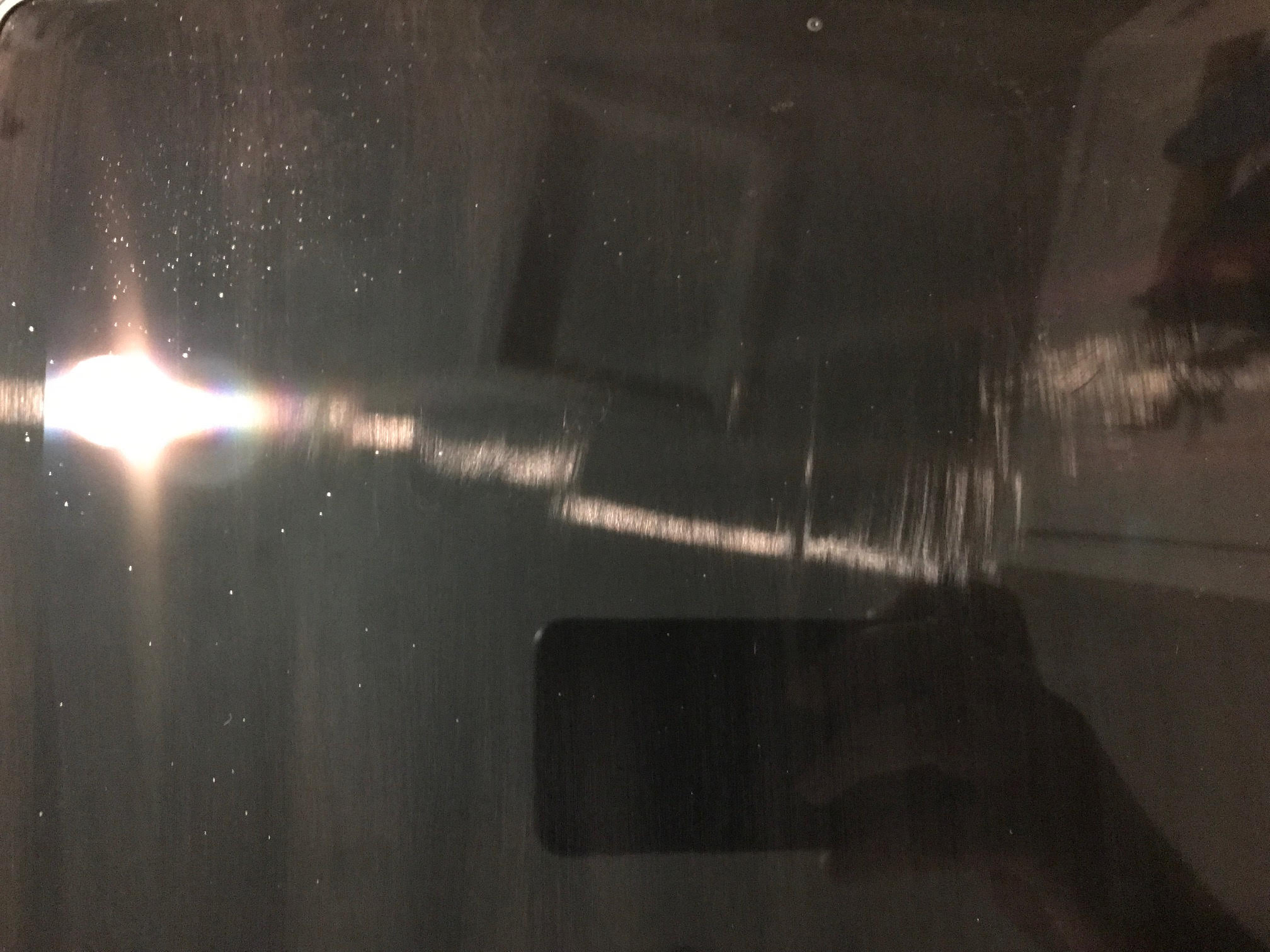

Hi All
This evening I cleaned the Macbook Pro Retina (2015) as usual with a micro fibre cloth and distilled water (spray bottle). However, I noticed these small dots as shown in the picture (only visible at certain angles). At first I thought it was small stubborn particles, but after attempting to repeatedly scrub at them, they still remain. Looking back, I have noticed these dots for at least 6 months, which, up until now felt were removed when I cleaned the screen. I only noticed them today as I left the desk lamp on (luckily) which was glaring at the screen.
I have owned the Mac from new since June 2016 and bought directly from Apple with 3yr warranty. Are Apple likely to replace the entire display? Would be interested in hearing from anyone else with a 2015 MBRr that has experienced similar issues!
Cheers.

It's the coating starting to fail. Apple will replace the screen but it's likey to happen again. Distilled water is one of the safest liquids to use as it contains no particulates. Don't use any cleaning agent.

Please don't. That will just speed up the deterioration. Take it into Apple (or any Apple certified retailer) and they'll replace it with a brand new screen. I had my screen replaced two years ago and it still looks brand new (I stopped using cleaning agents from Best Buy).

I agree that the coating is weak and a poor design for these laptops. I see many people have keyboard marks on their screen. These don't seem to have anything to do with the cleaning of the screen, but the screen resting on the keys. A thin microfiber sounds like it would have helped in these cases.
I had this on mine when I first got a 2015 model when it came out. It happened about two months after I got the machine. Apple replaced the screen for free.
Within a couple months, the new screen was doing the exact same thing. So I just learned to live with it.
They will replace it for up to 3 year from date of purchase. You can still get it replaced.
