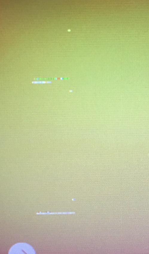

Hello, when I woke up the MBP this morning, I noticed some dots near the middle of the screen. After I logged in, they disappeared.
Such appearances of strange dots have happened a few times over the year but not too often. The location varies. About 1.5 month ago, they showed up on the dock. What are they? Is it a software glitch?
I'm not sure if it is a failed capacitor.
To test for a capacitor problem, run the Cinebench r15 OpenGL test. If the Macbook passes, it's probably not due to a capacitor issue.
It should not make it worse. I ran it a few times on my mid-2010 15". It's the test that confirmed I had a failed capacitor.
The capacitor is a known issueand was also the reason apple had an extended warranty program to deal with the problem. Unfortunately, the warranty program is over.
I ran the test: 15.53 fps (Ranked 7) for OpenGL and 192cb (Ranked 8) for CPU test. Did not see any fail or error message.
I am using OS X 10.12.6.
That's great so it doesn't appear to be related to the nVidia gpu. Unfortunately, troubleshooting the issue becomes more difficult because it could be a ram or hard drive too.
