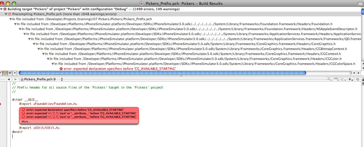

    Everything went as the book said it would (two build errors). I added the AudioToolbox.framework just as the book said, and compiling gave me 1499 errors. A screenshot of them is here: http://warptv.com/image/error.jpg.

  3. SergioQ thread starter macrumors newbie
    Joined:
    Jul 1, 2006
    #3
    I am going to look at your suggested solution. In the meantime am uploading the image in the hopes that looking at the error might give you a better idea of what is happening.
    p.s. If anyone knows how to save the Build Results to a text file (in XCode) that would be great.
    [​IMG]

    I think that you have added the MacOS version of the CoreGraphics.framework and you need to add the iPhone version of the CoreGraphics.framework. If you haven't added the wrong version then probably you have a problem with your framework search paths or one of the other search paths so that the compiler is finding the Mac framework instead of the iPhone framework.

    When you add the framework the wrong way Xcode adds the path to the framework search paths. This makes the linker find ALL the wrong frameworks, which causes the multitude of errors.
