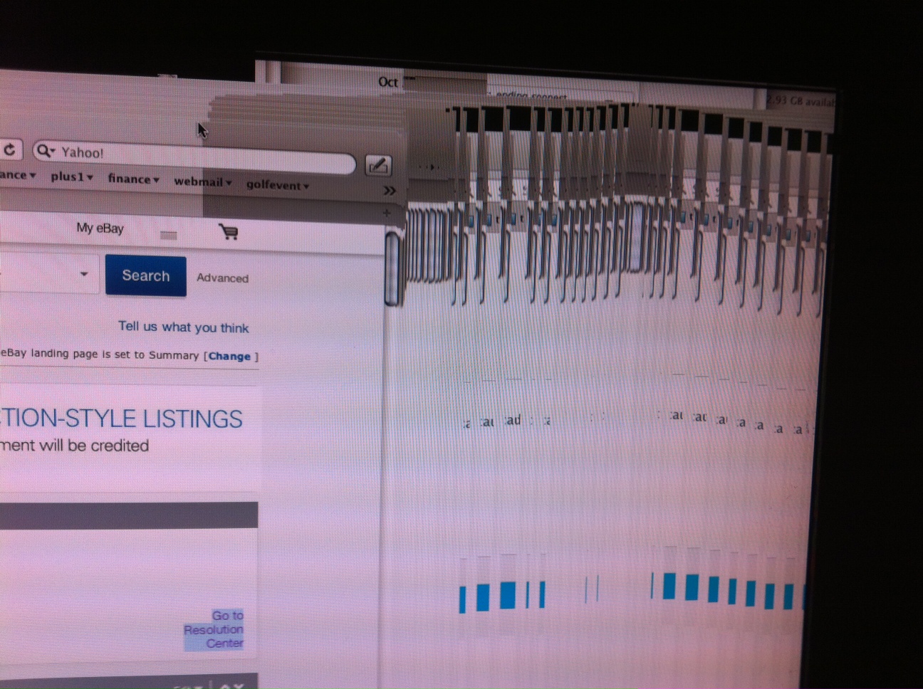

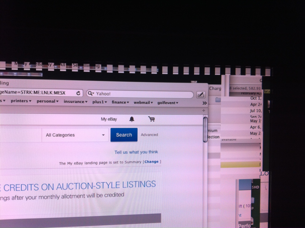

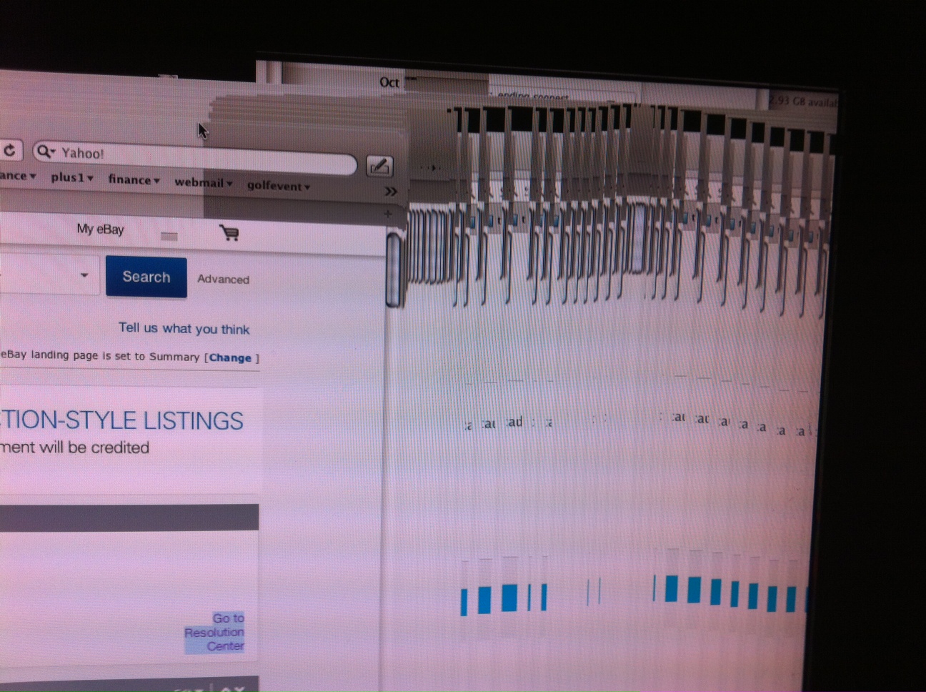

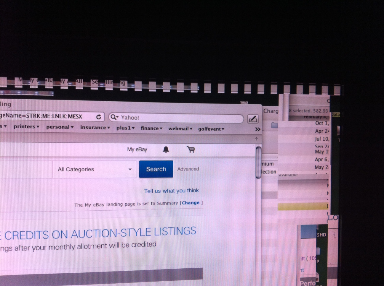

i have been having weird graphics issues on my mac pro 2009 also. i have a geforce gt120 gpu. i thought it was the graphics card failing, and purchased a used identical machine to try to decipher what is causing it. system has been sluggish the past month or so and i have 10.6.8 OS which has been solid and fast for me until recently. i also have been having odd repeating screen scrambles that are bizarre and no one on here seems to have any input.
i tried the other identical graphics card, still occurred. I switched my ram tray with the other from 1 x 16 gb to 4 x 2gb to see if that has any effect. and i also cloned my HD to a new SATA drive, and am booting off that to see if it may just be a failing HD.
is your issue different or are you seeing similar graphics? i attached pics of mine.
[doublepost=1462237242][/doublepost]i just cloned the hard drive today, restarted twice with the other ram still in. it seems to be running better, although i have not had any of the graphics issues on any consistent basis so it could just be coincidence. i am going through a process of elimination to try to see what the problem is in my case. i have ruled out the graphics card since it happened on both, as well as the ram. i think mine could have been the HD failing, or it is some issue with the CPU. if it occurs again, i will be down to either a ram issue, or the CPU, which i should be able to figure out since i have a second machine to swap everything over to.
When you see those graphics anomalies, take a screenshot. If the anomalies don't appear on the screenshot, your video card is dying.
