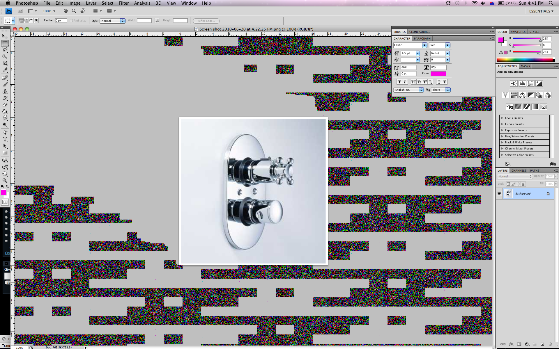

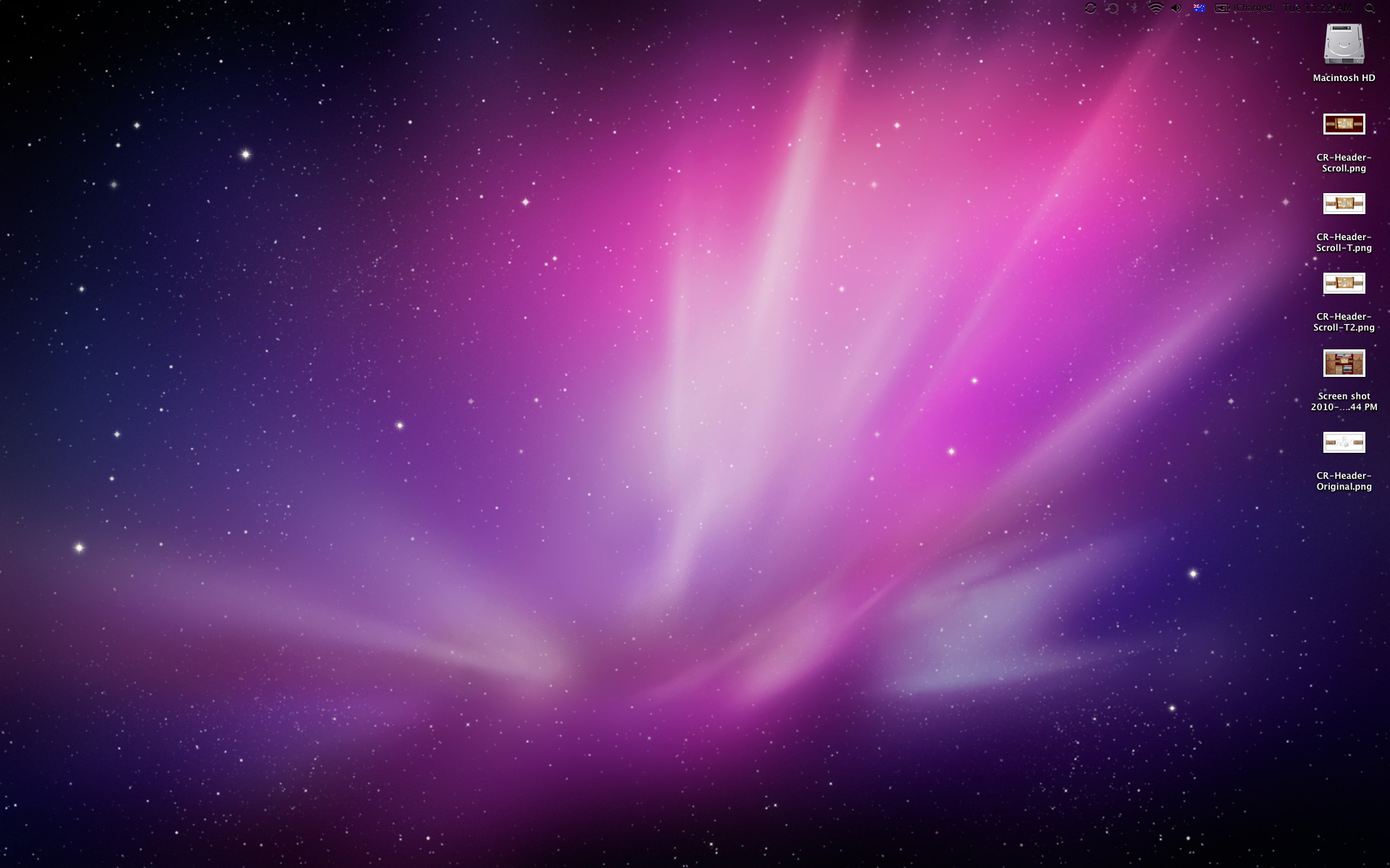

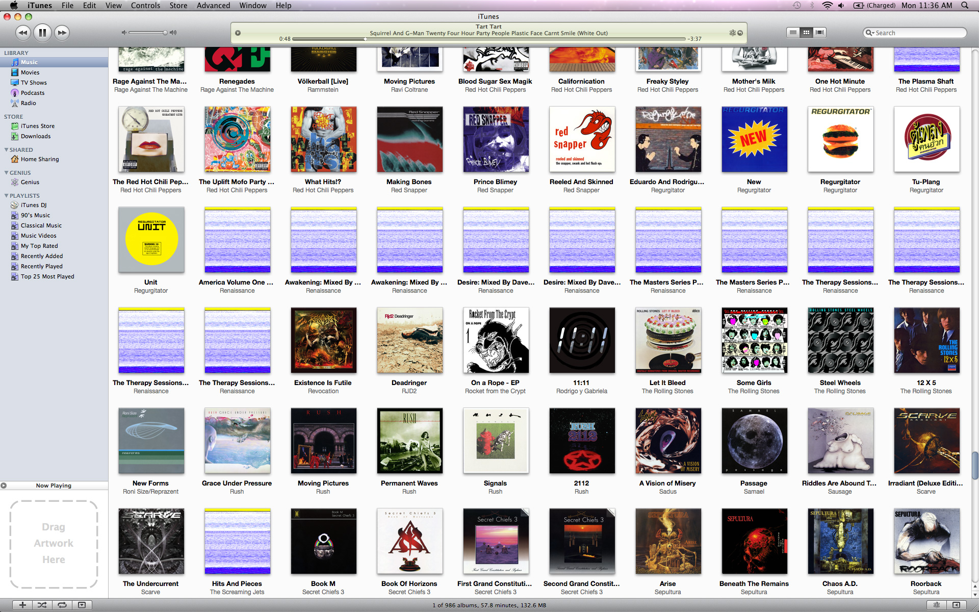

I've had my 17" i7 MBP w/antiglare, 4GB RAM, 7200RPM for about 4 weeks now and have noticed a few funny things happening on the graphics side of things within OS X/iTunes/Photoshop (and even when Alt + Tabbing between Word/Excel and Safari).
I've included a few screenshots with this this post that will show you what I am referring to. The Photoshop and iTunes issues should be obvious, the desktop shot shows how the gray bar at the top is missing.
If anyone knows what causes this or thinks I should raise it with Apple please let me know.

It could be helpful to know what exact version of 10.6.x you are running. Did this happen before the update to 10.6.4 (assuming you updated to 10.6.4)? 10.6.4 has been known to cause graphical issues.
looks like a memory issue and seeing that you're using photoshop and it's there suggests that it's the 330's dedicated memory.
It's worth a complete OS reinstall but I would just take it to Apple and see what they think. Do you have 10.6.4 installed?

The Desktop/iTunes issues occurred with the pre-installed version of OS X which was 10.6.3 from memory, and the Photoshop issue occurred just after installing 10.6.4. That said, the Photoshop bug was happening with 10.6.3 but didn't reoccur until I installed 10.6.4.

I take my MBP to a qualified Apple repair later that day and show the guy at the counter the problems. I show him how to replicate the problem in Photoshop CS4 and show him the screenshots. I show him the error that occurs in Google Maps (when scrolling in/out rapidly using a track wheel).
Fast forward to today and I am notified by the store that the issue was an Adobe issue - apparently I needed the 'Enable OpenGL Drawing' issue box selected. I tell them of the error in Google Maps which they fail to reproduce, so install a program called 'gfxCardStats. The techy admits that there's been issues with the switching between the Intel chip/nVidia card on these machines so I can use that to select my preferred video preferences.

I actually brought in my laptop and dropped it off to the guys at the Genius bar at the Apple store today. One of the guys who tried diagnosing my laptop said it could be a problem with my graphics card. I was able to bring in my laptop to them with/while the error was happening in order to show them.
The guy examined it and noted that when he switched the automatic graphics switching off, it fixed itself. He made note that it could be possibly a problem with the discrete graphics.
