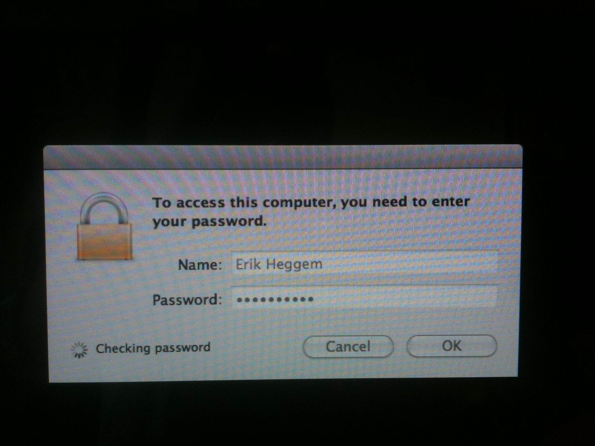

My mac hangs at login after sleep. Hangs so long that i cant stand to wait and shut it down with the powerbutton. The mac is connected to an AD-server and my account is defined as a mobile account. (also admin)
The strange thing is that we have several other macs and users with the same configuration and I havent heard any complaints from them.
The problem comes about every other day.
Se attached picture for the "hang-screen"
Snow Leopard 10.6.4, connected via ethernet, disk permisions repaired and so on. 😉
Any ideas is greatly appreciated!
Thanks!
Erik
