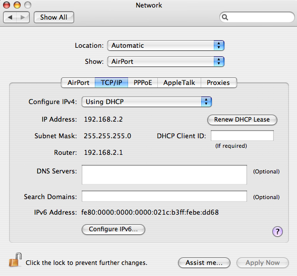

To see if you are using DHCP, go to Network Prefs, click on your Airport, click Advanced and go to the TCP/IP tab.

Ah, it appears that I am using DHCP. How should I go about changing this?

You've lost me there. If it helps, this is what I have in my Network settings:
The same problem occurs when I use Firefox, so I don't think it's a browser problem.

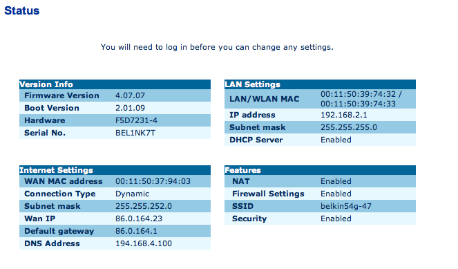

To setup a static IP address, you need to access your router's status page.
Access this and grab a screen shot. Then post it here. We can then guide you into setting up a static IP on your Mac.
That's the status page, though I can't actually log in at the moment because I don't know the password. I'll have to wait until my landlord returns in a couple of days.
