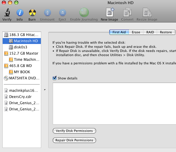

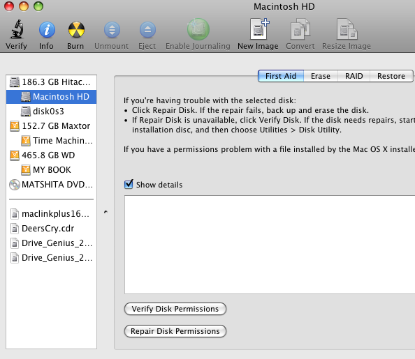

- Start disk utility from the applications>utilities>diskutility
- click on your Mac Hard Drive
- Click on repair permissions
see attachment

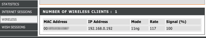

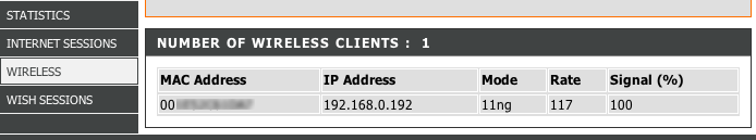

- access your router (usually through your browser)
- each vendor will have a slightly different configuration, but you are looking for active connections or wireless connections. See attachment. That 11ng stands for 802.11 connecting at N and G modes. You can see that the data rate is 117 Mbs which is pretty good, but not the maximum of wireless N's theoretical 300 Mbit.
