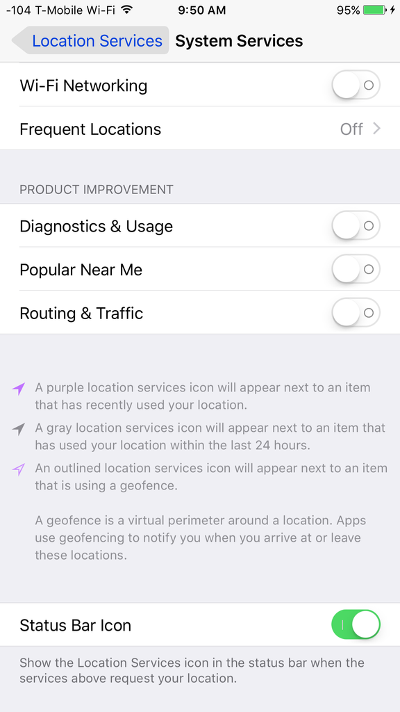

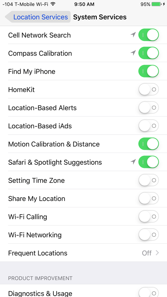

Have you looked at your location settings? Sometimes these can remain on in the background when no apps are open. One feature called Frequent Locations can definitely cause the issue you are having.
Go to Settings\Privacy\Location Services and looks around to see if "Share My Location" is turned on or if any apps are set to always use location services.
Your System Services should look similar to this:

Thanks for the tip. The app location services were under control but I shut off a bunch of the unnecessary system location services.
We'll see where this takes us.
