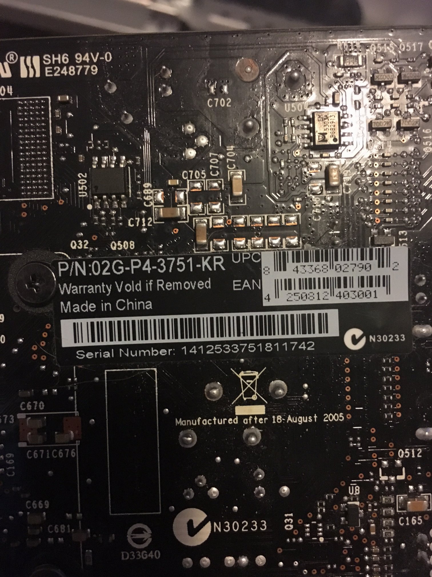

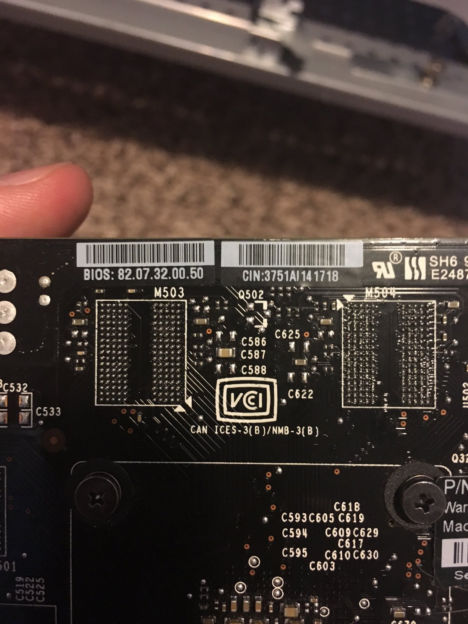

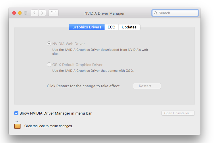

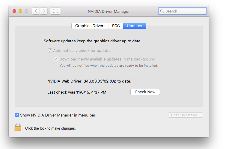

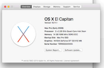

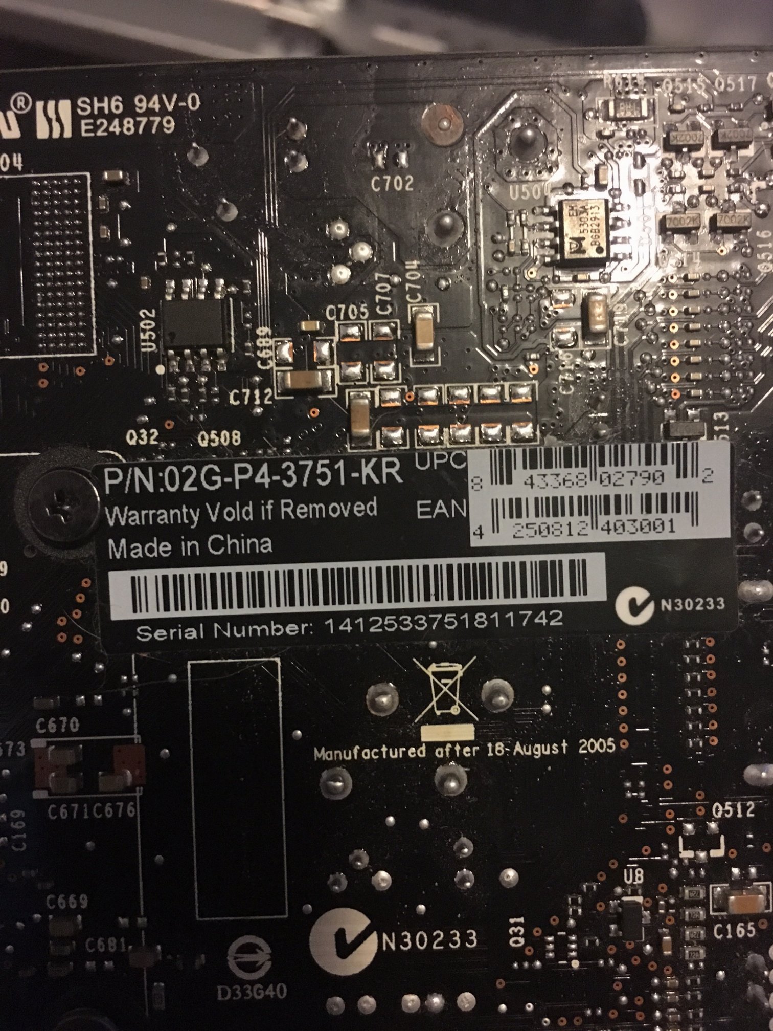

Ok so I have a 4,1 Mac Pro with a GT 120 in it and I happen to have laying around is a EVGA 750ti. I read on here that it works with my mac and el capitan so I gave it a try and no go. I hit the power button, fans start up and hard drives start spinning but no chime. I tried it in slot 1 and 2. Tried both the 120 and the 750 at the same time. Then in the opposite slots at the same time just in case. Display hooked to one, display hooked to the other. Its not a driver issue because it doesn't get to that point, I never get a chime. Display is a 30" Apple Cinema Display connecting via dual link dvi. Specifics below. Thanks in advance!
So it doesn't have any port at all on the card available for extra power.... then I can't guess what's wrong.
Good luck!
Did you install and activate the NVIDIA web drivers before or after trying to boot with the 750 Ti in your machine?
Maxwell cards will prevent a Mac Pro from booting unless the web drivers are installed first. It doesn't matter whether or not another Apple-supported card (like your GT 120) is also present.
