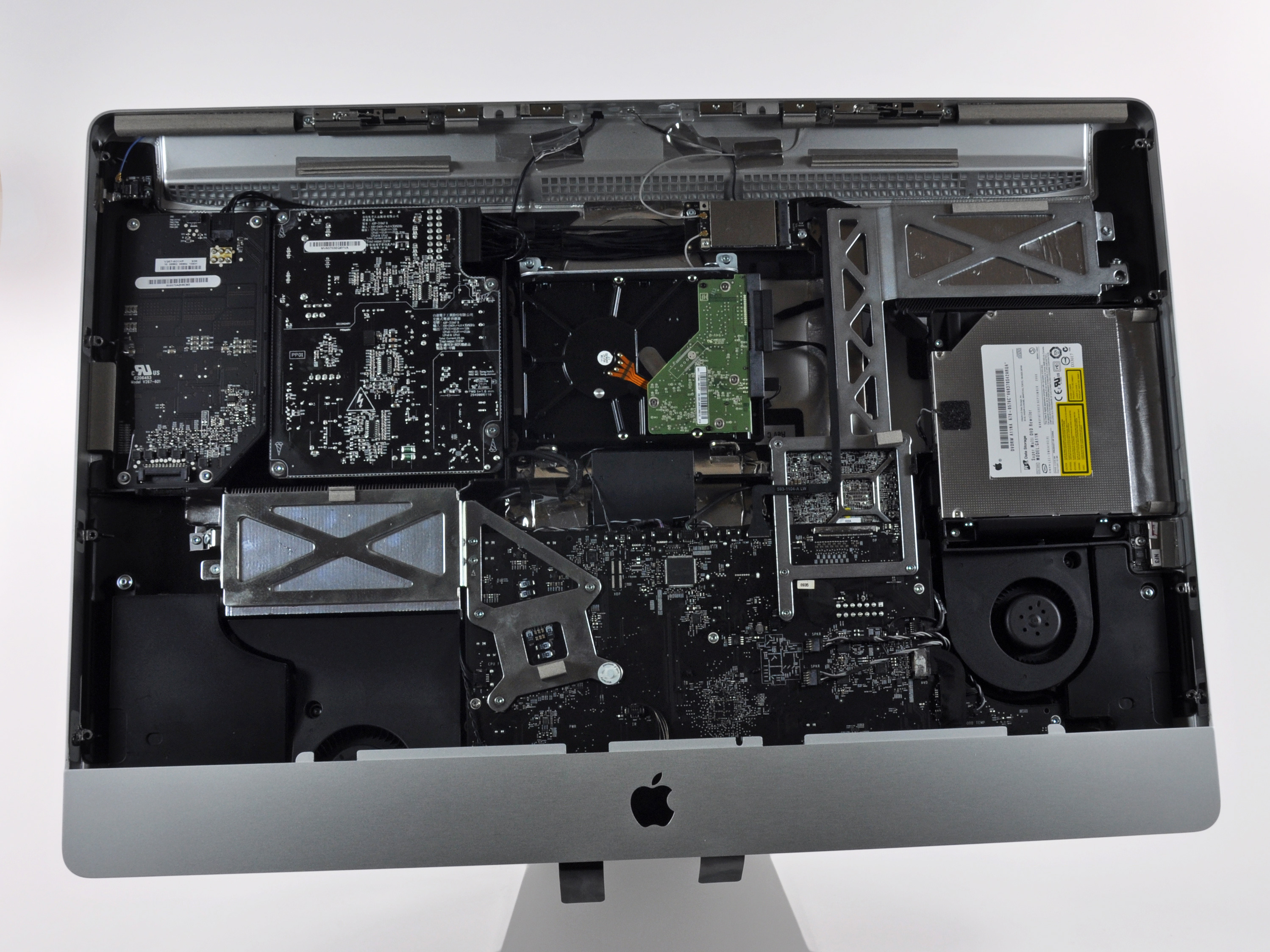

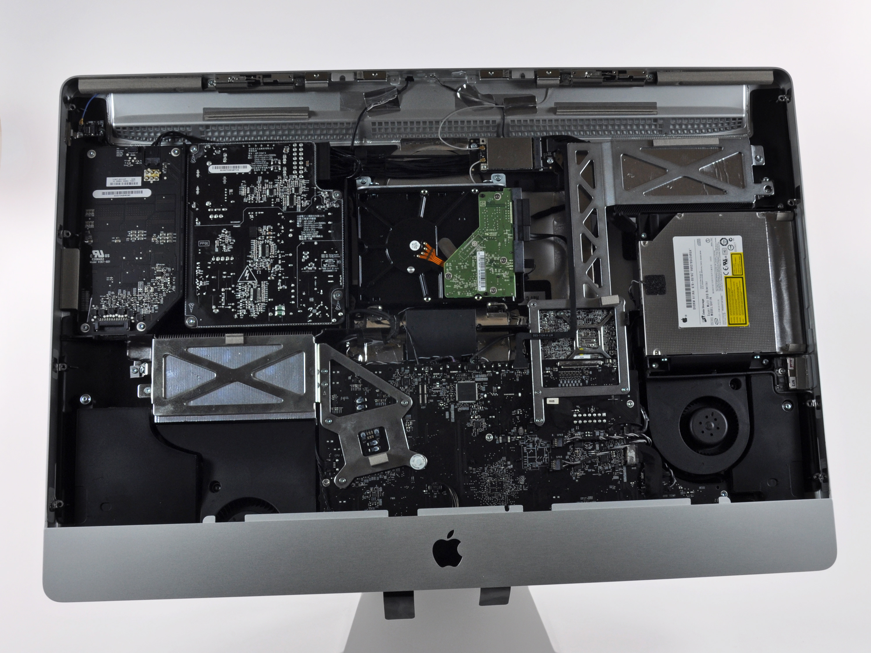

Here is a shot of the internals. The hard disk is just about right in the middle. There is a small fan for the HDD and then a fan on the lower left and lower right of the machine. The top left of the machine is the PSU and the LCD Inverter. Top right is the GPU heatsink (depending upon what GPU is in your machine):
TLfSqZEZWnTwKylR
Hope this helps!
Hope this helps!
