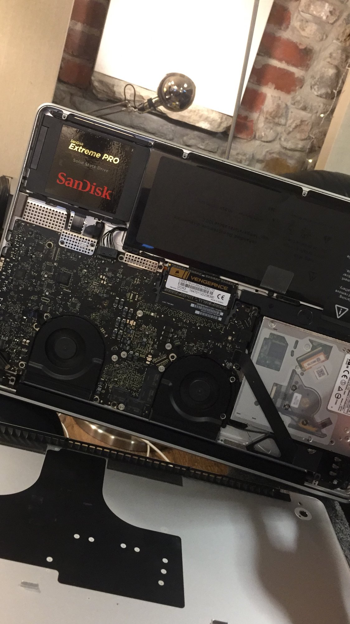

I’ve been given a 2011 17” MBP with good specs: Quad Core i7 2.3GHz, 16GB RAM, 500GB SSD. I’m trying to fix it for someone who is not able to afford to fix it themselves and needs help - I want to fix it and give it back to them to use, or sell it and give them the money.

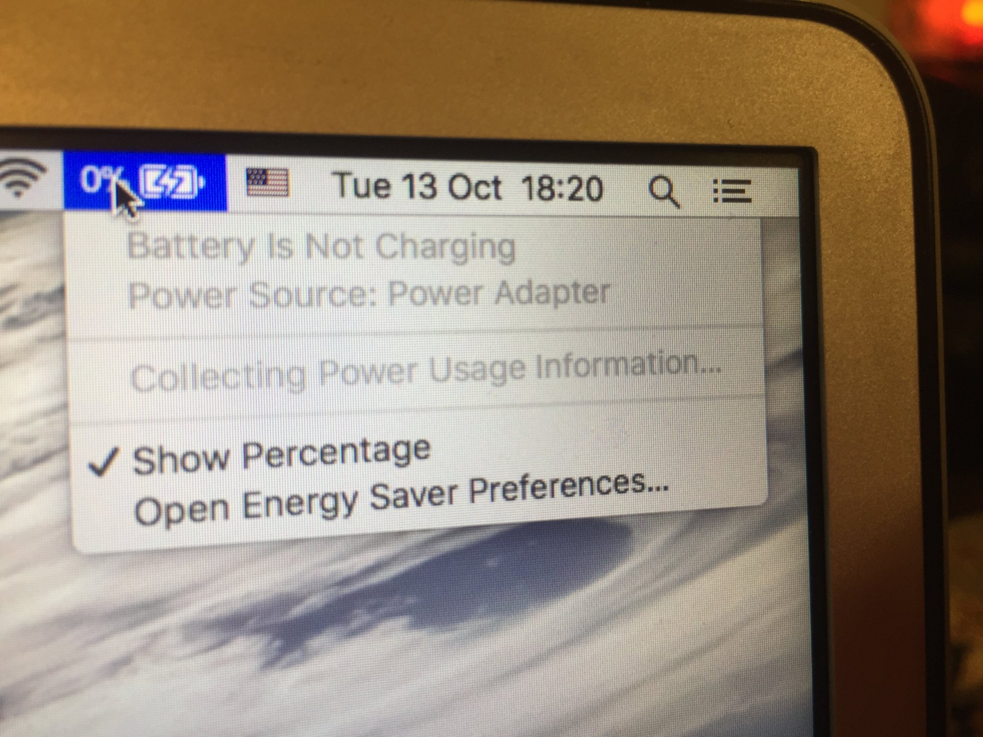

It’s in perfect cosmetic condition, but the problem is that the battery doesn’t seem to ever get charged (the machine does not boot without the power plugged in), and the performance is extremely slow when it boots. It has a new, 3rd party battery, coconut battery pic attached.
A couple of days ago, the machine was booting (enabling me to get the photos below and see which processes are running) - but currently the machine is caught in a cycle of wanting to boot, then shutting down just as you get to the login screen, then booting again. I believe this machine is from an era where it boots up automatically when power is attached, which is why it keeps booting up again, randomly.
When it does/did get to the is the kernel_task process which is taking up all the CPU (I assume this is a power management issue due to having 'no battery attached'?), however the machine is not getting hot. It’s just very slow.

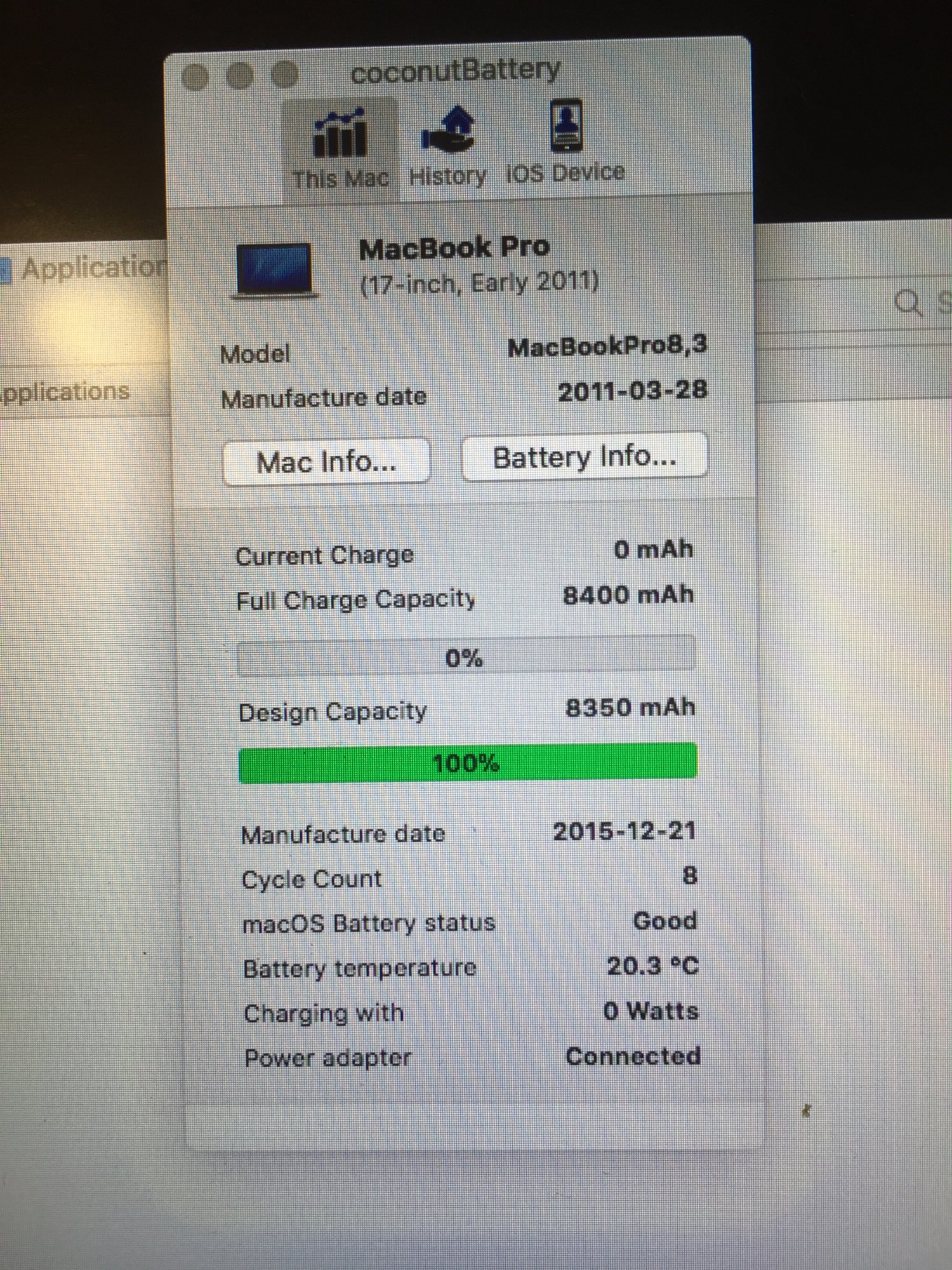

  • Looking at Coconut Battery app. Photo is attached.
It looks like the battery is third party, however the performance is bad with the battery disconnected.

MacOS will throttle the CPU if there is no working battery detected.
My guess is that the battery is bad or the logic board's charging circuit is bad.

Edit: As an update, I just disconnected the battery and tried to start the MBP, and it worked (albeit extremely slowly). With the battery connected, it would often restart half way through booting up. This is a little bit of evidence that the battery may be at fault here.
