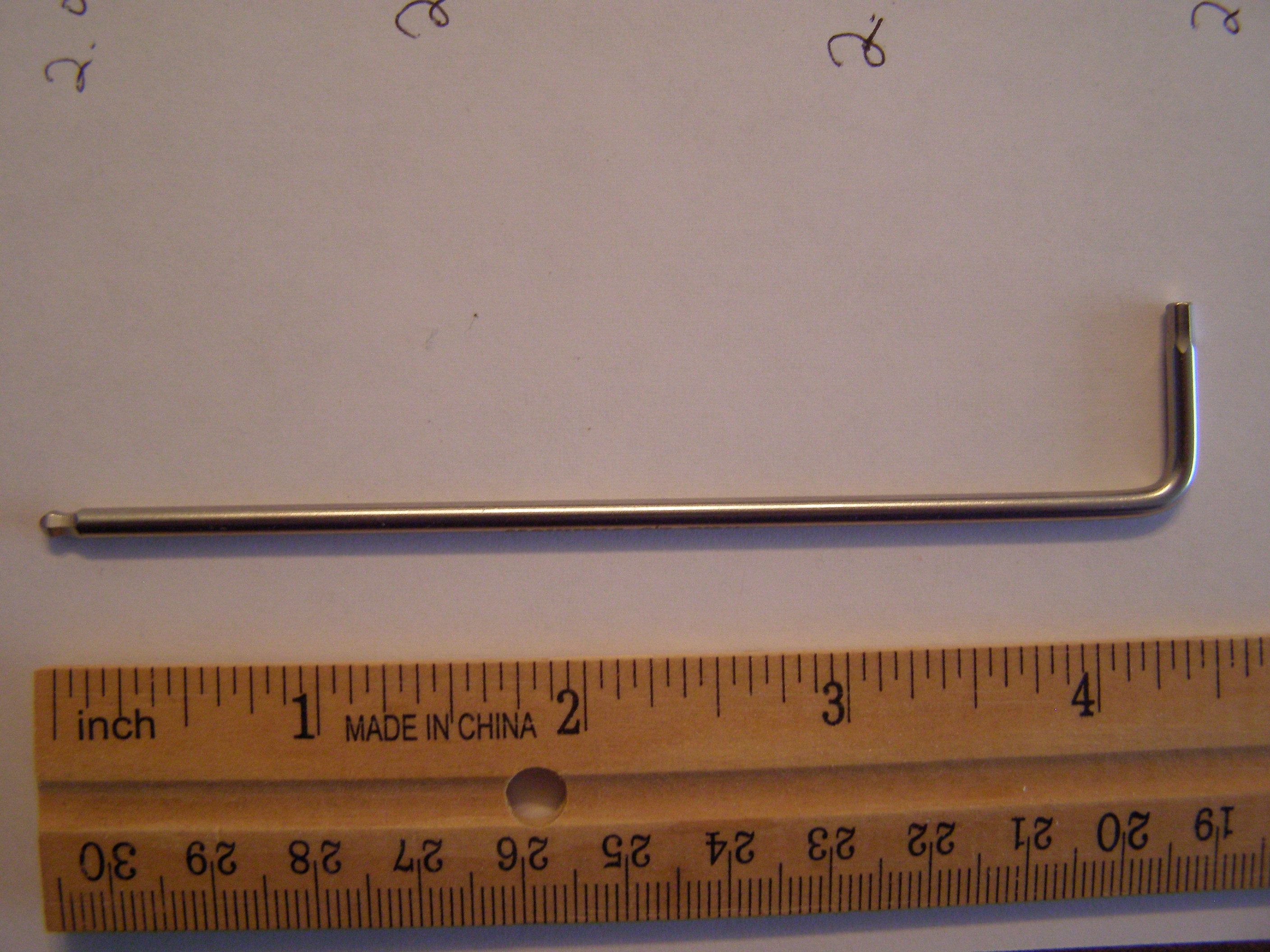

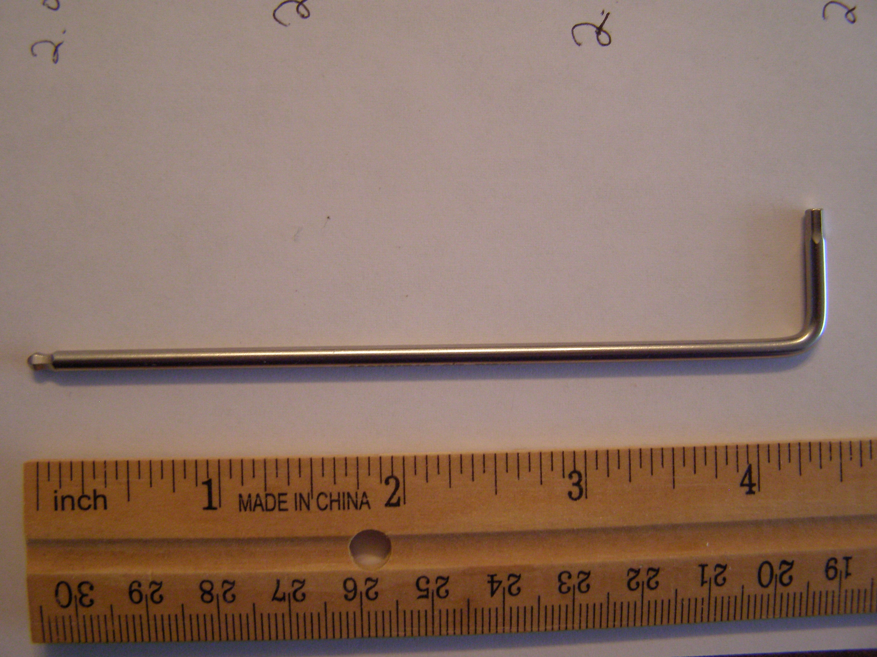

When removing the PSU, be sure to use a properly-sized 2.5 mm hex key. The bolts are pretty soft. I'm wrestling with a stripped one at the moment.
I use a Wera 2.5mm stainless L shaped hex driver , for removing cMP PSU and Processor board cage screws . One end is ball headed .
I use a Wera 2.5mm stainless L shaped hex driver , for removing cMP PSU and Processor board cage screws . One end is ball headed .View attachment 621692
