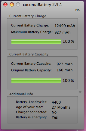

Well it just did it again. This time I was copying a movie to it. I have reset the pmu so I will just have to see what is going to happen. Attached is a screen caputre that I got from coconutbattery, it seems a little concerning to me.

Well this past Sunday I was able to make it down to the Apple Store and the verdict on the strange shutdowns is that the battery was holding at 600 while it was fully charged.
Well he replaced the battery and I started telling him about some other problems that I was having and he said well it sounds like you have a logic board problem. So it is off at a repair facility getting everything looked at.

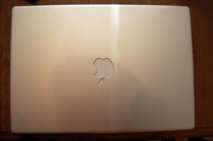

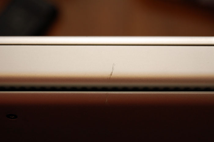

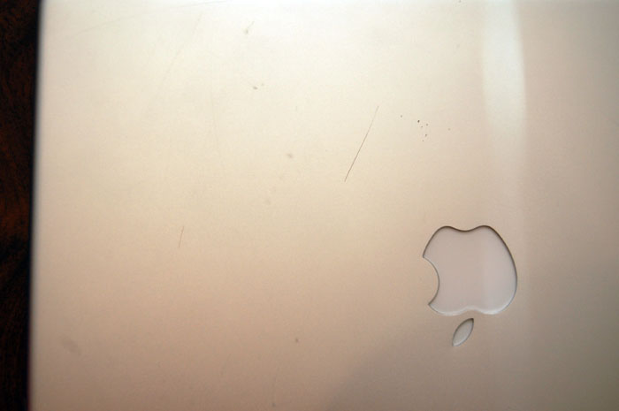

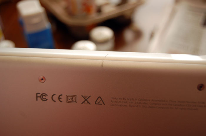

Well I got my PowerBook back last Friday, but when I opened the box I noticed that it was rather dirty. Well dirt isn't a big deal, it can be cleaned off pretty easily. But when I got to looking at it closer there were some pretty bad scratches that we not there when I sent it off to AppleCare. I was pissed, I called up AppleCare and talked to someone about it. They told me that they would be glad to send me out a box to ship it back to them in, and if they felt they needed to change the case they would.

Well my PowerBook made it back in today. I just broke open the box and they have replaced every piece of the case except the inside piece that is on the same level as the keyboard and the ram cover. It looks nice and new again, AppleCare has redeemed themselves.
