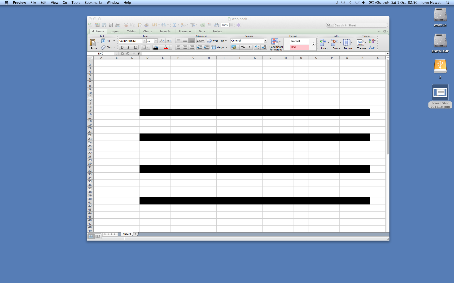

I don't really know how to describe it other than to say that when I open up a window that I have centered in the screen, and I drag it around the screen, I can a "ghost" of the window running all the way to the left and right edges of the screen.
The areas of highest contrast in the window are most visible. It is not a clone of the image, just a very obvious "shadow" of it. I cannot see it running from top to bottom, just left to right, regardless of which window or software I have open.
Is this a common thing?

I created a simple Excel Spreadsheet with a couple of black rows so that you can see the effect all the way to the edge of the screen.
What is the explanation for this? It happens regardless of which GPU is engaged and regardless of the brightness on setting of the screen.
I[m not sure if it's appearing in the screenshot or not. It's difficult to explain, but when I place another window over the top of the captured image and cover up the black bars, the strange effect disappears even from the screenshot...

There are no artifacts present on that image when I view it.
I would try to reinstall the OS in case it is an issue with a corrupt driver or file. If that fails I would take the machine in repair as it is hardware related.
I am betting it's hardware related since the screen capture doesn't have any issues.

Since it didn't show up in the screenshot, it means the issue happens after the data leaves the video card, which means you almost certainly have a bad LCD.
Bring it in.
(and why did someone -1 my previous post? The answer to the question of whether you CAN take a screenshot is horrifically important. If the issue shows up in the screenshot, it absolutely narrows out the LCD and LVDS cable. If it doesn't, it narrows out software and video memory.)

I contacted AppleCare on the phone and they booked me in for an appointment at my nearest Apple Genius Bar, which is an hour from me.
I drove there and the "genius" recognized it and straight away said it will need to be replaced but couldn't be done then and there because they would need to order in a new screen. So I would have to drive back a second time to drop it off next week and a third time to pick it up a few days later.
She said it's not a GPU thing, just a screen thing, so that's the part they're replacing. I asked her if it could be graphics related because my system does not dynamically switch to the integrated GPU, but instead just lets the battery drain on the discreet GPU, even with no software open. She said "It doesn't switch automatically." I replied, "Yes it does, it's called Dynamic Switching." She started at me as though I hadn't even spoken.
