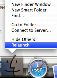

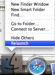

I'm sorry my mind totally slipped on the last post, I meant relaunching Finder, not restarting my computer 😱
and by relaunching finder I mean pressing the option key, right clicking on the finder icon, and clicking relaunch

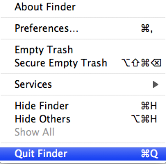

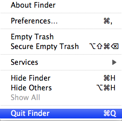

Um.... either this:
or this:
or this:
followed by launching Finder.

To add a Quit Finder entry to the Finder menu, in Terminal type:
defaults write com.apple.finder QuitMenuItem -bool yes​
Then relaunch Finder.
To access Finder's Relaunch menu item from the Dock, hold the Option key down while you right-click the Finder icon on the Dock.
