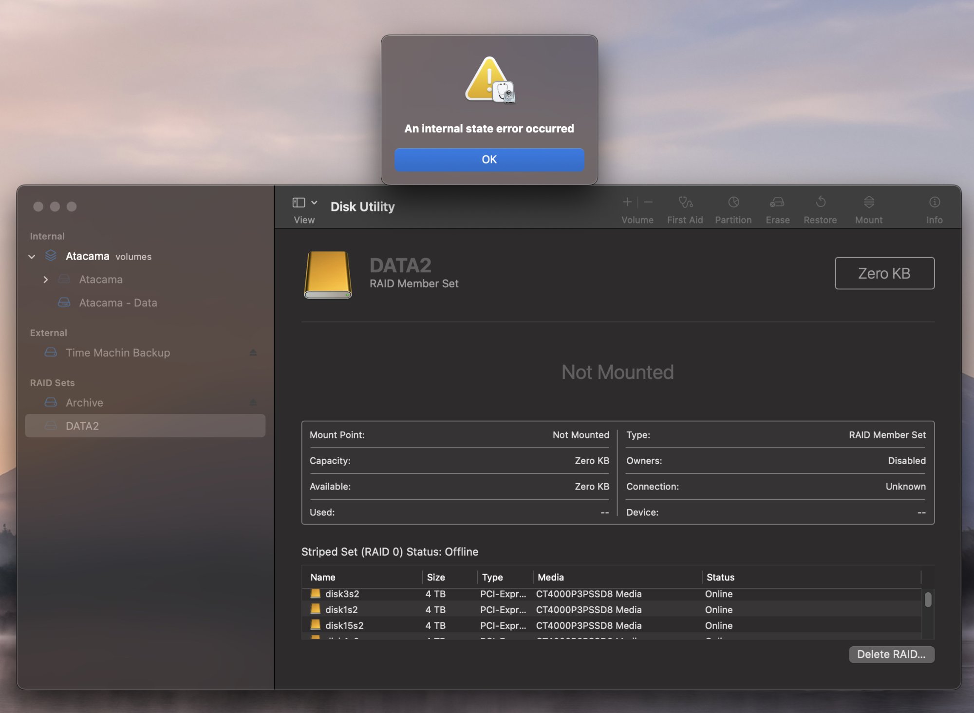

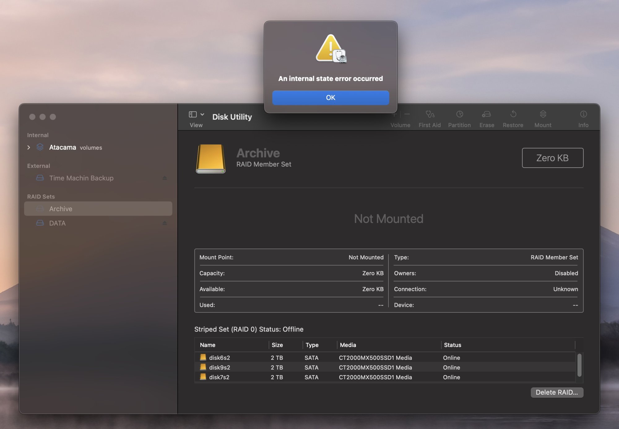

Hi,
I just finished updating to 15.3.2, and immediately have a problem. Machine is iMac Pro.
I have three external volumes. One is a WD external disk as a time machine backup drive. This one does not have problem. The problems are with the other two. Both are TB3 external enclosures configured for RADI0 (created using Disk Utility), called "DATA" and "Archive."
The two RAID0 volumes worked quite fine previously. After 15.3.2, only either one can be mounted. There were four reboots after the 15.3.2 update. One reboot is associated with the OS update, then three more attempting to resolve the mounting issue. The volume DATA was automatically mounted after two reboots, while the volume Archive was automatically mounted after the other two reboots. I went into Disk Utility to try to mount the unmounted one, DU refused to mount it and told me that "An internal state error occurred." (Please see the screenshots.)
So it seems the Mac can mount any one of the two RAID0 volumes, but not both at the same time. After each reboot, it alternated between the two volumes. This was not the case before the 15.3.2 update. Previously both can be mounted without any problems.
Anyone has an idea what's going on? What does "An internal state error occurred" mean exactly? How can I resolve this?
