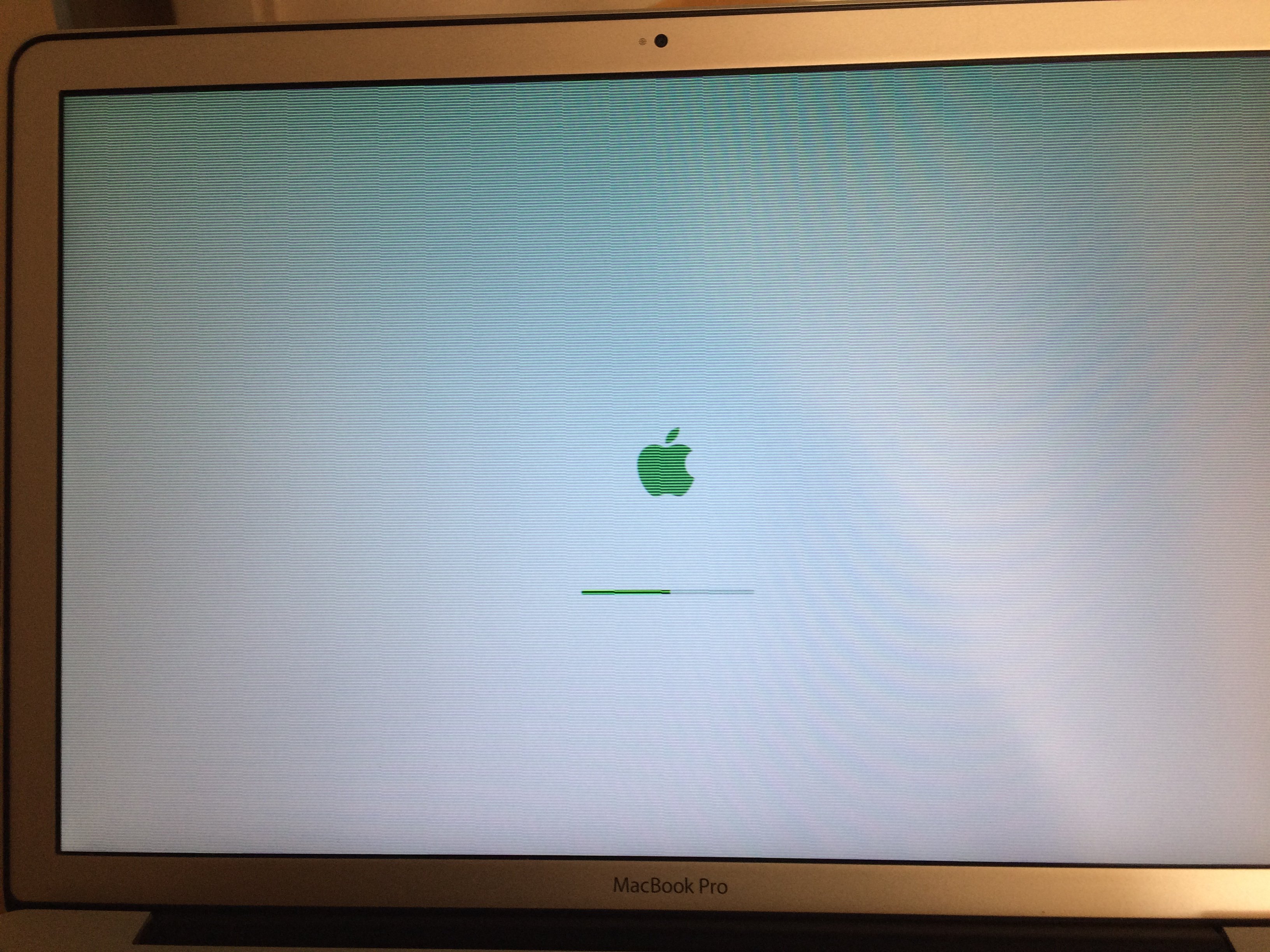

About two weeks ago - prior to the O.S. upgrade - my laptop began having issues with freezing up. I would have to shut down the computer and restart it. It would work fine for a long time but then it began to happen more often.
It then started to display a strange screen when it started that was very grainy and had horizontal lines running across the screen and a light Green color apple would appear with a Green progress bar below it. The normal sounds would happen and I could hear the H.D. spinning up and the chime sounding. Eventually the Gray screen would appear with a darker Apple logo and the proper progress bar. The laptop would be up and running and everything was fine again.
A couple days ago I ran First Aid in Disk Utility and again everything showed no problems. I ran AVG virus software and it came back with no viruses found.
I've used my desk top computer to check for possible cures and since then I've tried doing the O.S. upgrade and that went well. Shortly after the upgrade, the same problems happened again. I tried starting while holding down the Command R key, no success, Holding down the "D" key brought me to the AHT page and it was very hard to read. Very grainy again and it had a deep Blue background screen and a light Gray box for commands. I ran the regular program and the extended version of the program and I got results that read 4MEM/9/40000000:eek:X8473B618 a couple of times. I ran it again and it came back with no problems found. When I ran it again today, it again came back with the same 4MEM message.

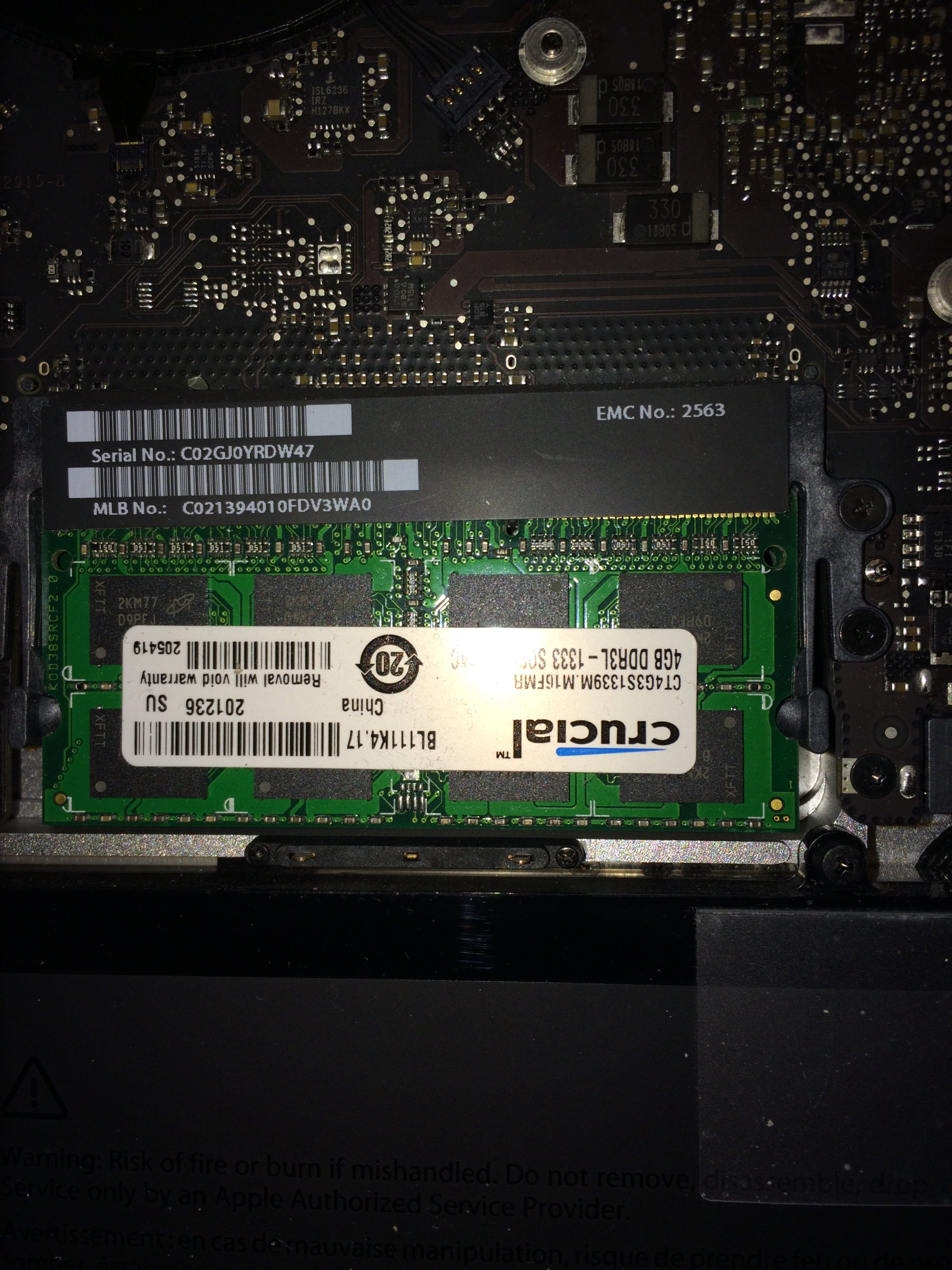

I opened the back and checked the 2 ram chips 4 GB each and swapped their position in the computer. Again, I got the same repeated attempts to start up and the Green Apple screen.
The laptop will not start at all now, it attempts to start and eventually goes to a Black screen and just stops.

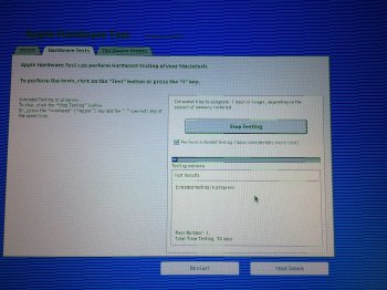

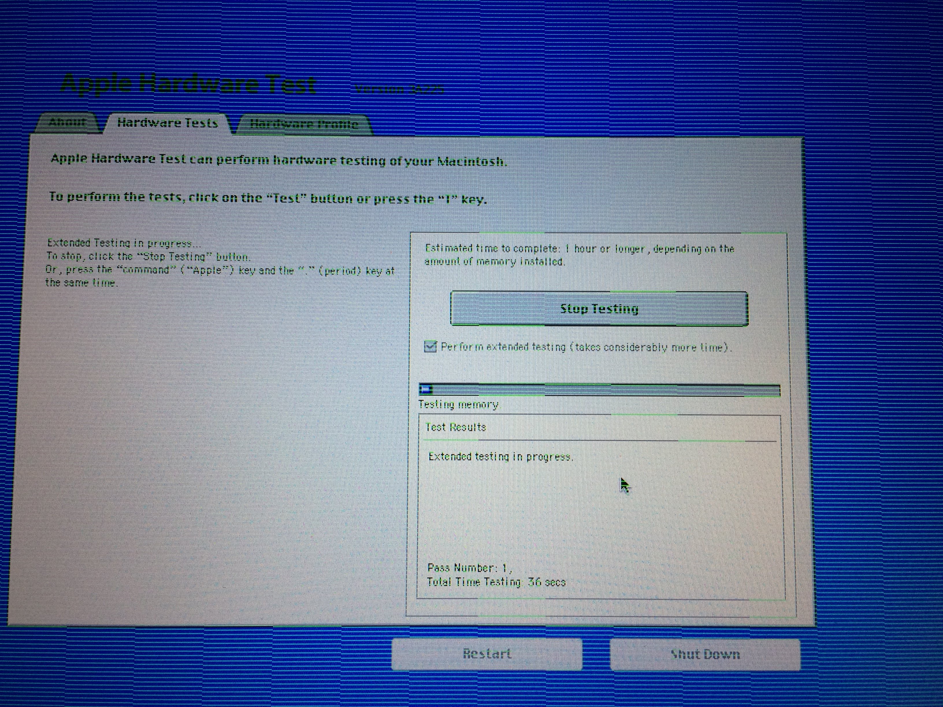

So I'm at a loss. If the memory chip(s) are bad, why would I get conflicting messages at the AHT test? The problem began before I did the O.S. upgrade. No viruses found, it happens while on battery power and while using the electric cord. I did notice that it seems to be running quite warm especially while a heavy graphic screen is shown (when it was running). I'm going to try to post a couple photos of the screen as it appears now.

I believe your dGPU is failing.
I think this is whats happening here. You may also have had a piece of malware on your system - which you seem to have removed - but this is very unlikely to be the cause of the graphical glitches you report in your OP.
I think there are various reports on here of the dGPUs in 2011 15" MBPs being faulty, and this is likely what you're experiencing.

It's your dGPU not a virus. Stop banging your head against the wall.
To paraphrase Einstein, insanity is doing the same thing over and over expecting different results.
Reactions: Mr_Brightside_@
FYI, this is the program/issue that's affecting your Mac. Because the non-retina MBPs have been vintage'd, it's no longer offered for them, however.
https://www.apple.com/support/macbookpro-videoissues/
Unfortunately I do not believe this will work on OP's computer, as OP has a 2011 model. The repair program only applies to 2013/13 retina MacBook Pros. It couldn't hurt for OP to ask Apple what they could do, but I seriously doubt they will offer to repair the computer under the repair program, considering the model year it is.
The repair program covered the 2011s while replacement parts were still available, but was updated to exclude the 2011 after replacement parts for the model were discontinued. (The replacement parts were junk anyway, and often failed again rather quickly.)
As for the OP, horizontal stepped lines running through a discoloured Apple logo is absolutely a dedicated GPU failure. No doubt about it. Nothing short of a hardware repair or a replacement computer will address it either, although there are some temporary workarounds here on the forum that others have documented.
