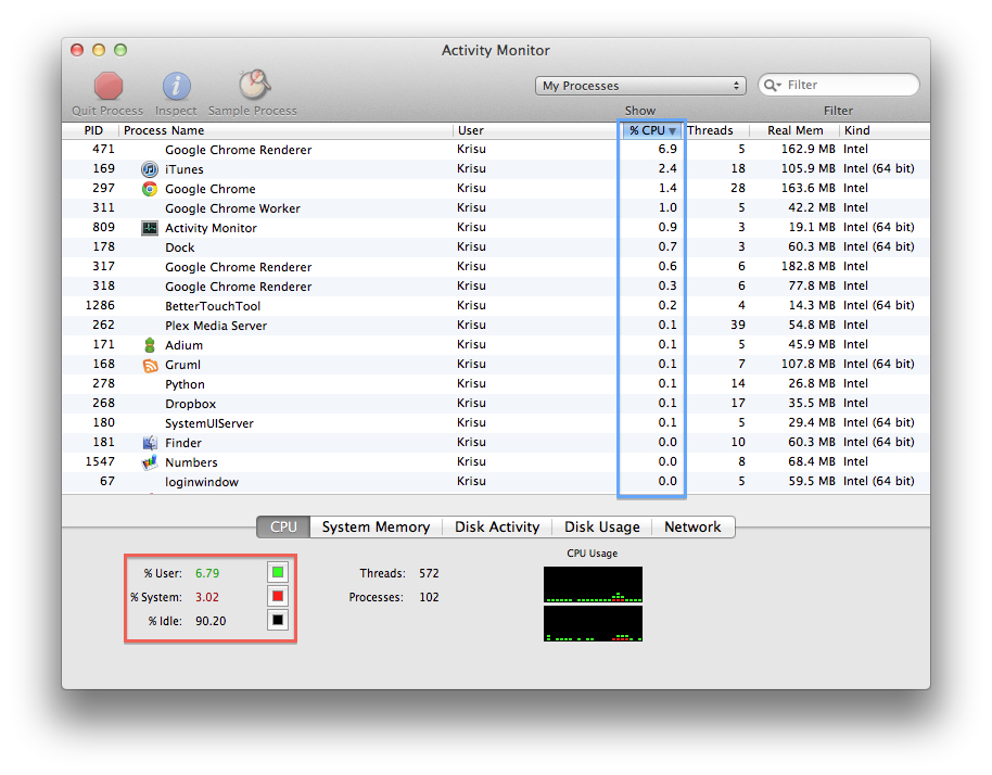

Is the CPU load the total load or the load for one core? The difference is, 15-18% total load can be 60-72% for one core if the process is single-threaded. 70% load might be enough to trigger the Turbo mode, which causes more heat. I made a quick picture to show the difference:
The blue area can have CPU usage of up to 400% in your case because the usage is by each thread (you have two cores but due to Hyper-Threading, you have four threads). However, the total CPU usage (highlighted with red) cannot be higher than 100%.
Also, the GPU is integrated into the same die as the CPU so while your CPU usage may be low, the GPU can be running that full speed.

Thanks for the info. So do I just count the total % in activity monitor, to confirm if the usage is higher than the [red] total?
