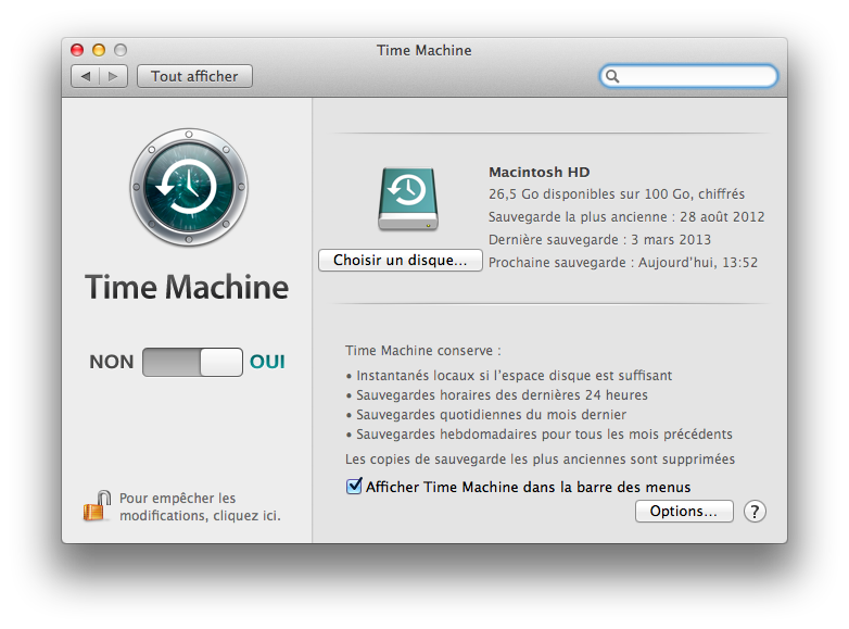

Thank you switon; I really appreciate your efforts to help me out.
Right now, my usb backup drive is disconnected. When I run the destinationinfo command, I get my (disconnected) drive's name. And yet, when I go into Time Machine preferences, the name of my backup drive is Macintosh HD!! Take a look at the screenshots (my backup drive is called "something", obviously).

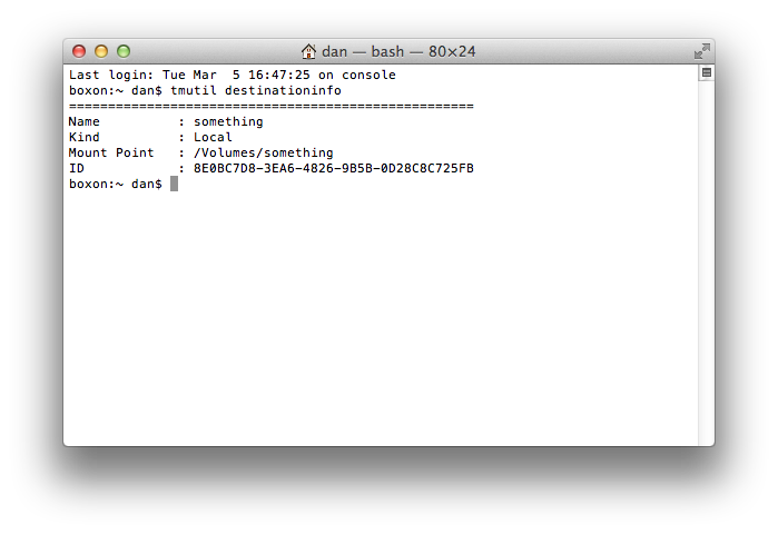

Dear switon,
Now that's interesting. To answer your last question, when my external HD is mounted, I indeed get /Volumes/ as its mount point (see screenshot). Then, when I unmount it and run the destinationinfo command, I get the same result as above. So, since my external HD seems to be mounting correctly, I'm reluctant to erase it and start over.

Ungar,
So, to summarize, when TM is backing up tp this external volume, then tmtuil destinationinfo returns /Volumes/<backupvolumename>.
Fortunately Weaselboy has found the same problem in the Apple Support forums, but the solution listed there is the extreme and somewhat unsatisfying "start over". But I always worry that the problem will happen again unless I understand why it happened in the first place, which is why I try to fix these problems instead of just starting over.
