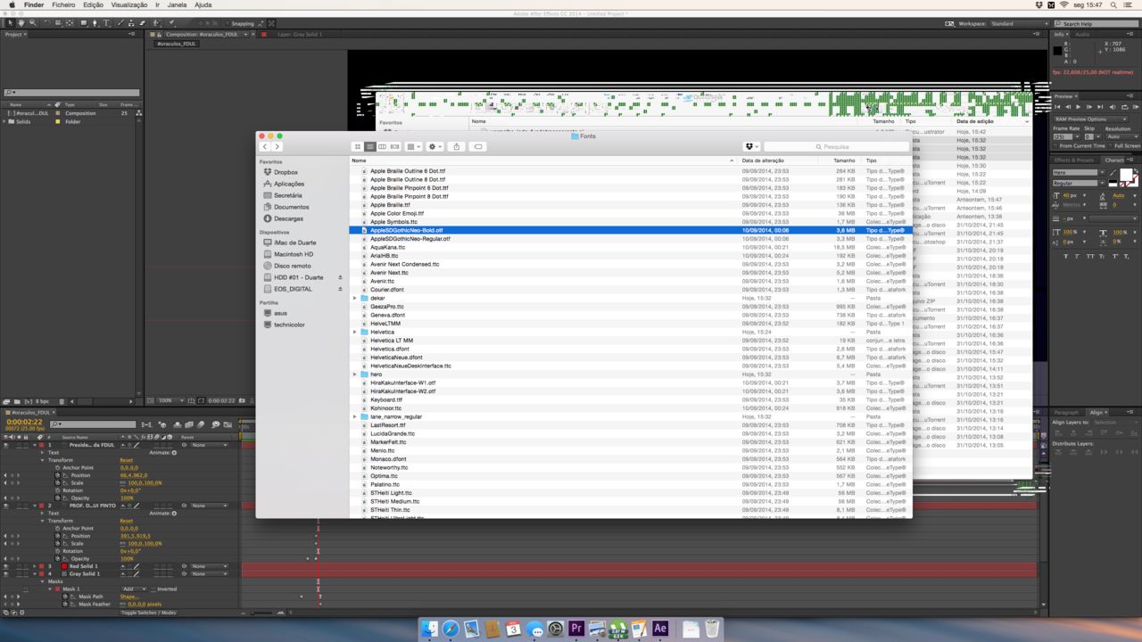

I just bought a 27' iMac. I had it for 3 or 4 days and now I start noticing some strange artifacts on the screen.
and
e2ndcygx9
These are a couple of examples. Is this a known issue? What could it be? I installed the CUDA Drivers to use on Premiere Pro, but could that cause this kind of problem?
and

This is the other example
it might have to do with premiere or CUDA because I only seemed to get this since I installed it. I'm gonna try to run premiere in openCL, or not run premiere at all to see if I get the same artifacts. They come and go, for example I rested now and they didn't appear yet.
Sorry - totally assumed you had a new retina iMac. Either way, I would do a fresh install of the OS. Any machine I buy that has an OS "pre-installed" gets wiped and reinstalled before I use it. This way I know it wasnt a pooched install.
I had a customers mac that had the same type of issue Apple had to replace the main board booting to a clean I stall did not fix the issue only once the main board was replaced the issue went away
