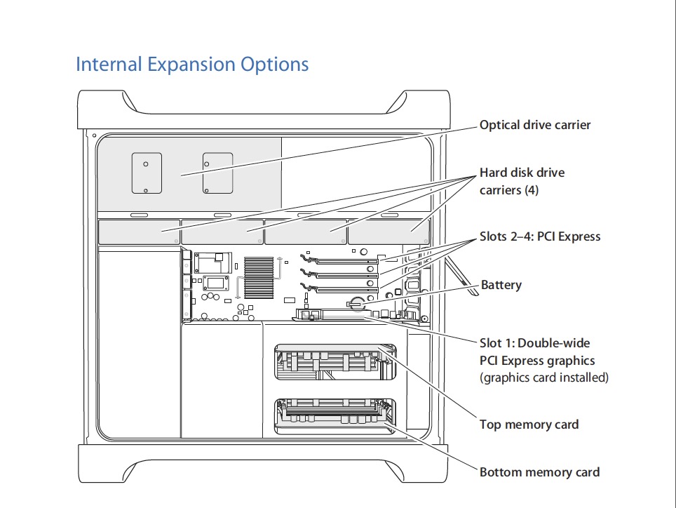

Do you mean Slot 1, the first slot (lowest towards the bottom)?
Did you try a different slot?
Sorry, yes, Slot 1, the lowest and closest to the memory slots (edited).
I swapped it to Slot 2, with no change in performance per Black Magic disk speed test.
Slot 3 or 4, by the way, results in drastically reduced performance, down to the level of a hard disk (150). This was somewhat surprising, since I believe the Duo is a 2-lane card, and those slots are 4 lanes.
Strangely slow Velocity Duo X2 plus RAID 0 Samsung 850 Evos.
Sorry, yes, Slot 1, the lowest and closest to the power supply (edited above).
Hi Ph.D,
No, the slots of the PCIe's are numbered the other way round. So slot #1 is the one closest to the memory trays.
Perhaps you could try and BM the SSD's in the SATA2 HDD bays first, to check their r/w readings are similar when inserted. The readings you should get on a RAID0 on the DUO in slot#1 or #2 is indeed around 750-800.
1. How long ago did you install the DUO and SSD's and what was your install/restore scheme? Perhaps there's a proces e.g. like Spotlight Indexing havely using resources.
2. What are the other components occupying your PCIe slots? Please share your config, remember slot#1 is the one closest to the memory trays.

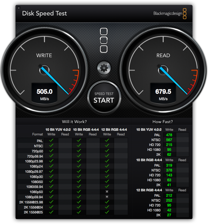

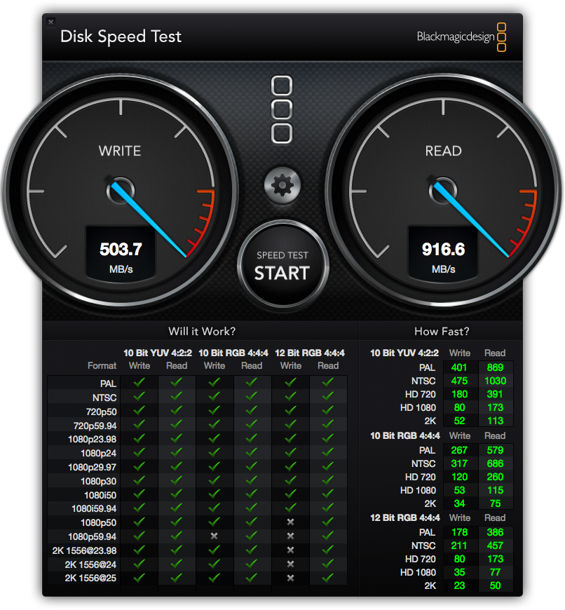

When I first received my Velocity DUO x2, I was intending to boot Windows and OS X from it. However, before I did I ran some RAID-0 tests against my Tempo Pro which I was currently using as a RAID-0 boot device.
The issue I was concerned about was that the Velocity DUO x2 was only a 2 lane card, whereas the Tempo Pro was a 4 lane card.
I used the exact same pair of Crucial m4 512GB SSDs, in the same slot, in the same 5,1 Mac Pro to run the tests. As you can see, there was a significant read speed difference between the cards when running RAID-0. (Note: it is normal for the M4 generation SSDs to have slower Write speeds than Read speeds).
Here are the BlackMagic test results:
Velocity DUO x2 --------- Tempo Pro (both in RAID-0)
Your write speeds on the DUO seems not right in resemblance to my benches ~ 700. Your read speeds do differ very much on the Tempo!

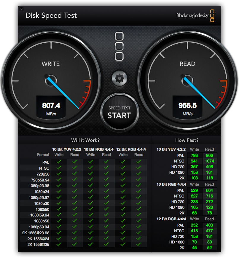

The Crucial M4 series does have slow write speeds which I see on every benchmark I run, so I am used to it. They are very reliable however, which is why I continue to use them. 😎
I also have used Samsung 840 Pro SSDs which are much more balanced with write/read speeds. Here is a test with a pair of 840 Pro 256GB SSDs on the Tempo Pro card ... much better writes! 🙂
Reliablity is the core! I agree 100%
Great numbers, that's what we want to achive upgrading our cMP! Thanks for sharing your info's!
