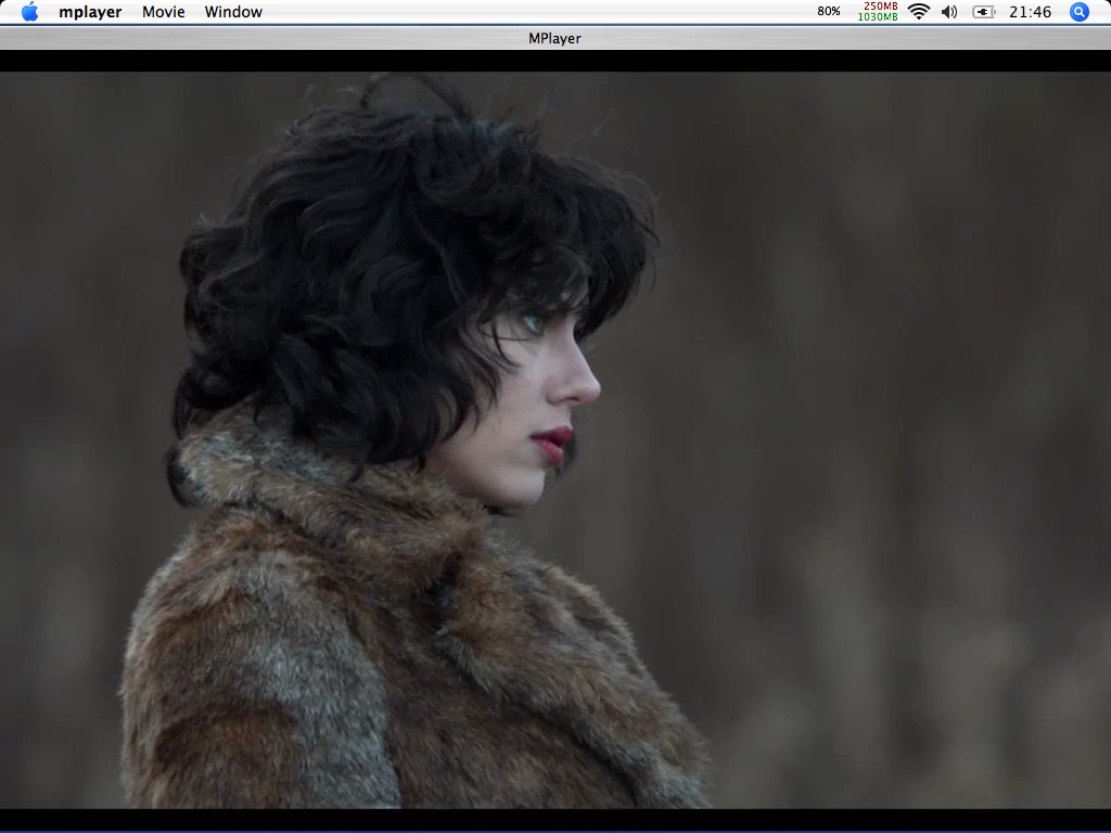

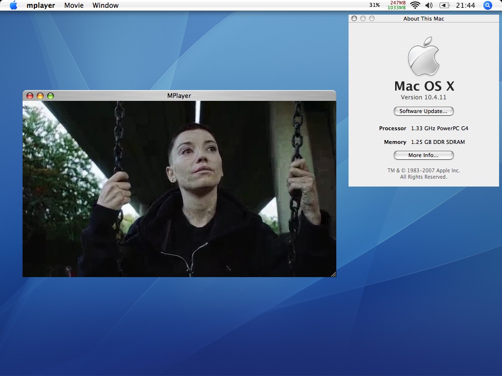

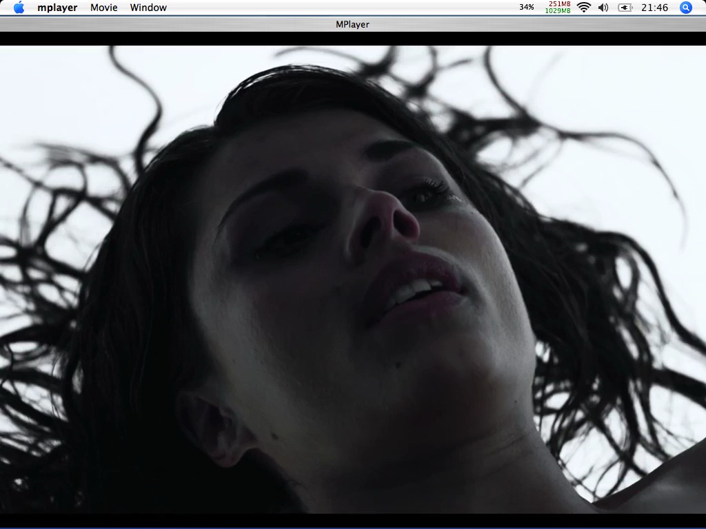

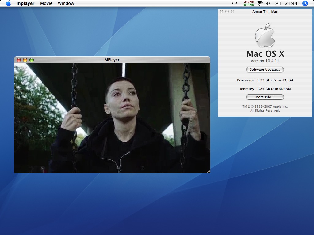

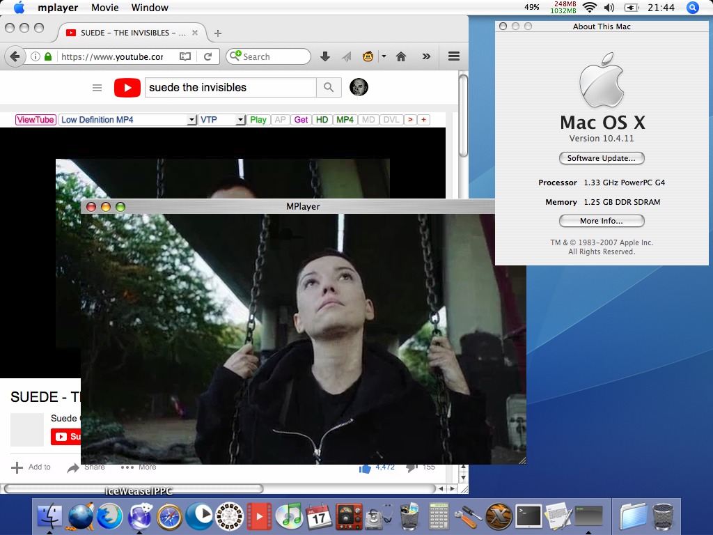

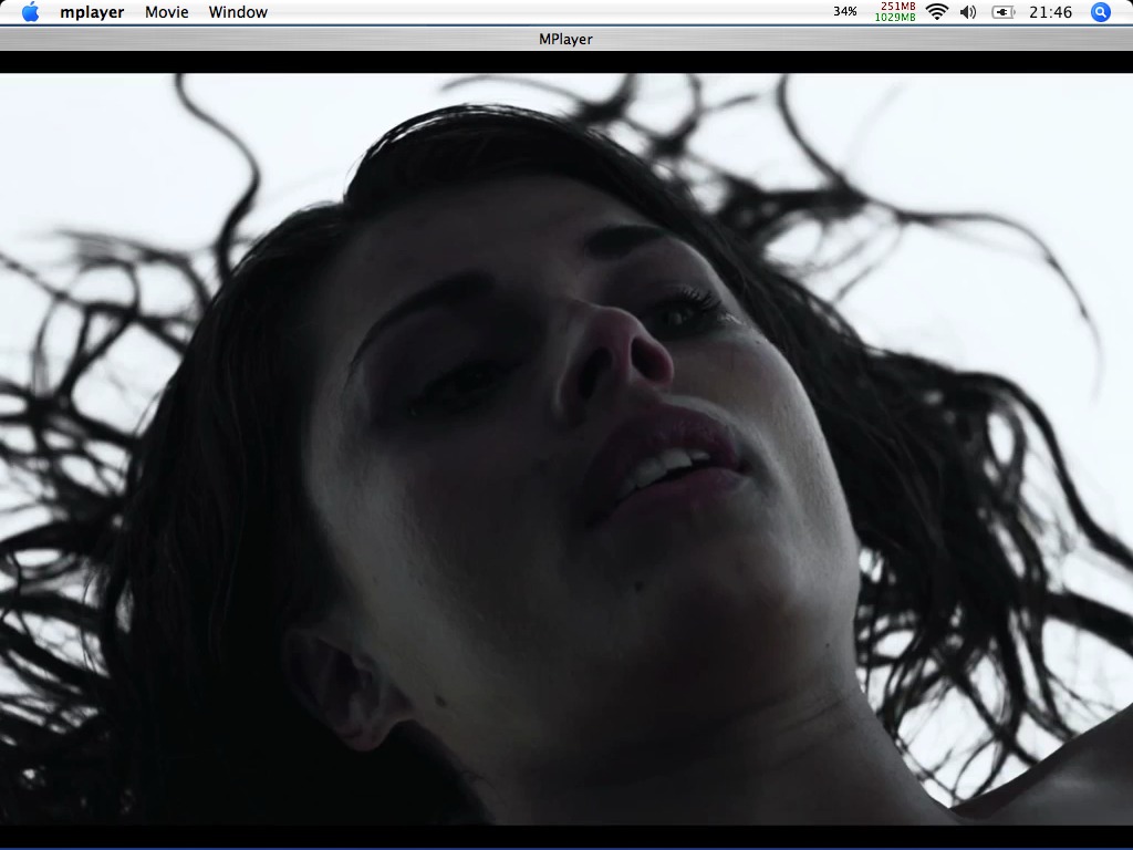

Largely thanks to @B-G and his thread here I've shifted the duties to IceWeaselPPC (thanks @wicknix ) and MPlayer to stream Youtube on my 12" 1.33Ghz Powerbook running Tiger.
As we know, Tiger is pretty much out in the cold now for Youtube options with SMTube on hold and security protocols leaving Safari, TenFourKit, Camino and Omniweb behind but this is an effective solution for streaming using the Greasemonkey add-on running the Viewtube script.
All I've added to the recipe from @B-G is changing to IceWeasel running IE 8 user agent (to stop the processor hungry latest Youtube GUI), replacing the prefs.js file with my own and editing the viewtube handler script to include some hard framedrop parameters for MPlayer.
For best results, once you've clicked to play, hit cmd+m to minimise the browser - it adds over 20%CPU - minimised, MPlayer drives 360P at around 30% CPU - switching to 720P the CPU rises to between 50/80% depending on content. Going fullscreen is visually better and saves some cycles - I left it windowed in the screenshots just to show the CPU use.
EDIT: Use TonVid to search for videos, then click on the Play on Youtube button which will send you to Youtube which activates Viewtube.
The Viewtube script can be modified as per instructions by @vddrnnr to remove Youtube comments and sidebar. I've further modified script to automatically select VTP plugin choice and added instructions to viewtubehandler to automatically minimise IceWeaselPPC.

Those MPlayer parameters for anyone who tries it :
-framedrop -lavdopts skiploopfilter=all:skipframe=nonref
Hi Drone,
I'm doing something similar to you using ArcticFoxPPC by using it's hability to dinamically
change the User Agent coupled with ViewTube.
Right now the best I can get is using the Chrome v41 useragent for youtube and
a customized ViewTube script that removes some parts of the web page ( movie llist on the right and
comments bellow ).
My pages open in ArcticFox almost instantly because it also cannot play the MP4 video directly
only webm.
Can you send me your script I would like to try and include the mplayer option in my script
which would solve the MP4 playing problem.
Also using the useragent trick I can use Gmail with the new interface almost perfectly ( Chrome v43 ).

That's interesting - I tried the scripting tactic from the TFF dev page to slim down Youtube as you've done but it didn't work for me.
Modified handler attached - note this requires MPlayer as bundled by @Lastic from his SMTube thread.
Keep us updated with how this progresses - there's still lots of options out there for folk who can script/program.

Very good! Does this work on a G3? 360p playback or lower? G3s could benefit from this, full quality audio and high quality streaming. Beats downloading and deleting 360p videos...
Not as it stands because the MPlayer version used for https streams doesn't run on G3 - however, changing viewtubehandler to QuickTime should work but will be more demanding.
At the weekend I'll look into this and see whether Viewtube can go to a lower resolution.
