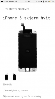

I dropped my iPhone 6 on the floor and two stripes across the screen appeared (from top to bottom). The touch screen barely works where the stripes are. Does anybody know what's wrong an how i can fix it? Thanks for answers

It's likely the digitizer and damage to the LCD display. The only thing you can possibly do is replace the display as a whole.

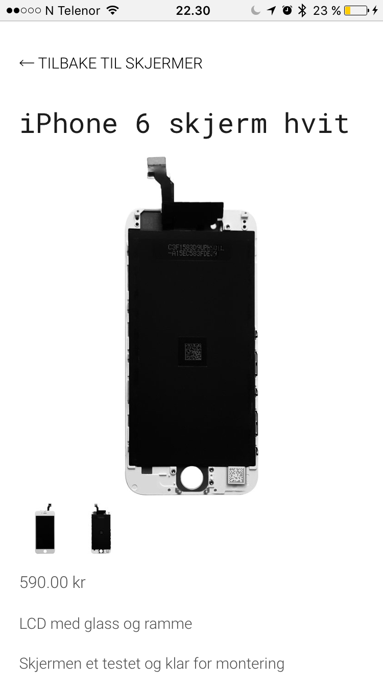

Does this work ? Its a complete screen with LCD and frame, but without home button (i think)

Before replacing the screen, try and test all of the phone functions to ensure that the screen is the only problem.
I know the screen isn't working but is it possible there is internal damage too? It would be disappointing to replace the screen and it doesn't resolve all of the issues with the phone.
Since you're going to take it apart anyway you should try re-seating the screen connections in the phone. Dropping, obviously, could shake those loose.
