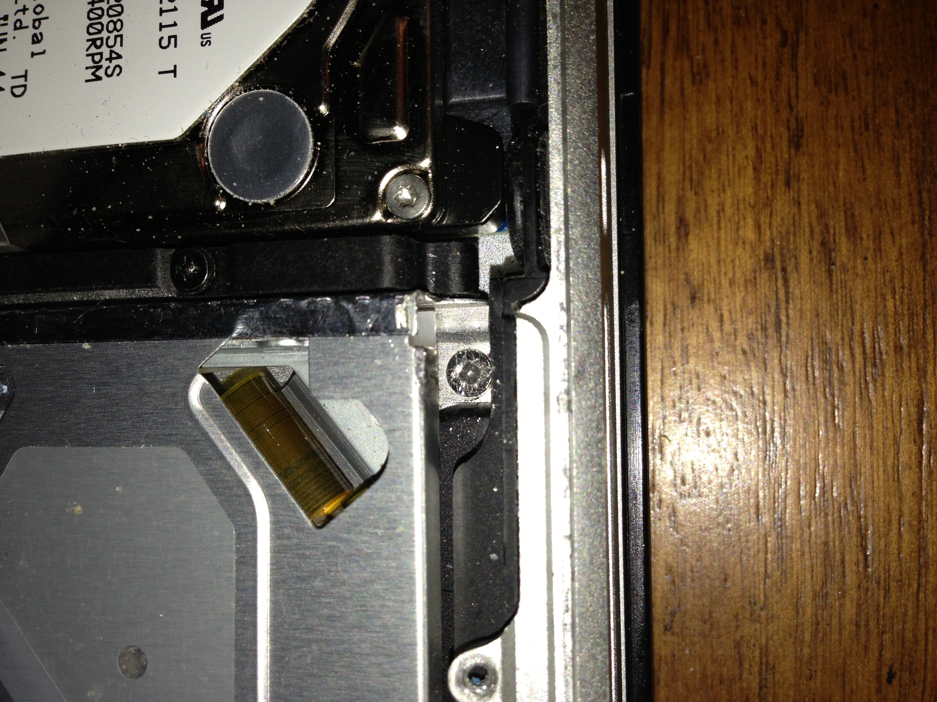

Hi MacRumors! I have a little issue here. While trying to replace my optical drive to place in an optical bay to put in a second Hard Drive in I accidentally stripped a screw. I stripped the right screw as you can see in the following picture
rAUl4NS6Yn2wDTLD.large
. Any suggestions how I could get stripped screw out so I can replace the optical drive? Thanks for any help in advance!
You could to to drop a dab of crazy glue and then put the screw driver in, wait for the glue to set and carefully unscrew it. You need to be very careful in not getting any crazy glue on any other component.
can you grip around the head with some needle pliers?
I stripped a screw once on the hdd bracket mount and thats what i did. Glad it wasn't a recessed head
i did the same thing before ,same screw, i just pull the drive out and the metal will bend and eventually break ,then you will have more room to grab the screw with pliers.
this is the last resort tho
stand up, put your body weight on it with the screwdriver and turn really slowly (assuming it is not COMPLETELY stripped).
