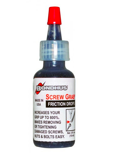

1. If there's an inkling of guide on the head left, you can try a friction paste that's specifically designed to take up the slack. Here's an example of what I mean:
Lightly tap the screw head also.
