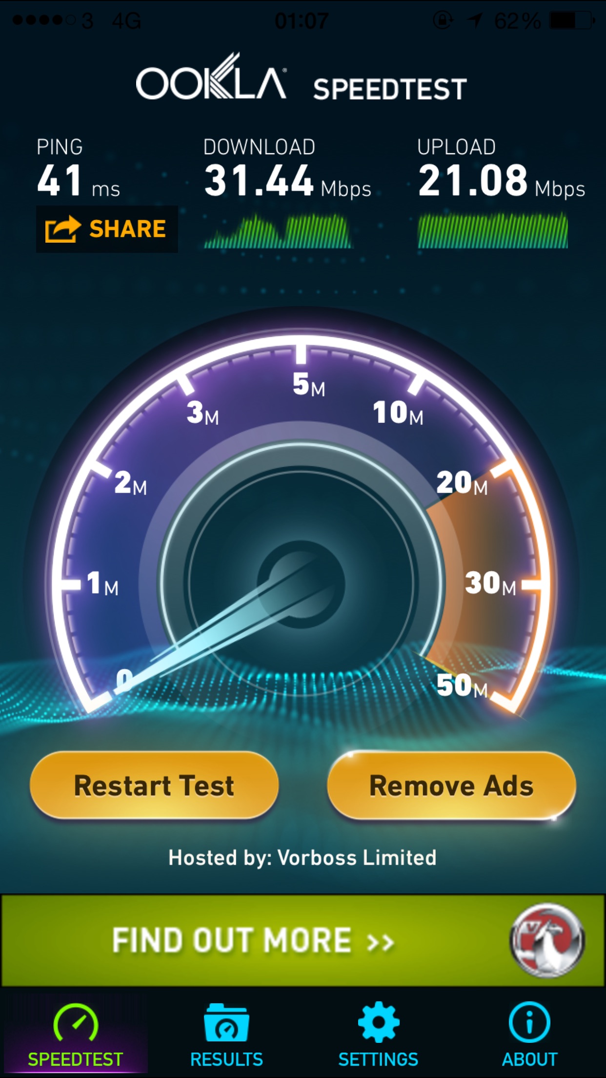

The iPhone 6 does support Three's 4G network. I'm currently using it on my 6 Plus and previously had 4G from Three running on my iPhone 5S. It's not your phone that is the problem but the lack of 4G signal in your area. I think you should put in a complaint to Three about not getting the advertised signal in your area as per their signal coverage map. (Coverage maps are not very accurate anyways, but don't tell them you know that 😛). You could potentially get a discount and could terminate your contract. Also, they do offer indoor signal boosters, but I think they are for calls and texts only. It is possible that they may be doing maintenance works in your area which is affecting the signal strength, so worth having a look.
When their 4G does work, it's very good. Since 4G came to my area, I've been getting speeds on average of 30mbps+ down and ~20mbps up. Here's one I did just now:
