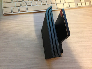

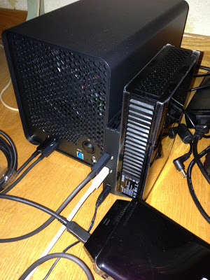

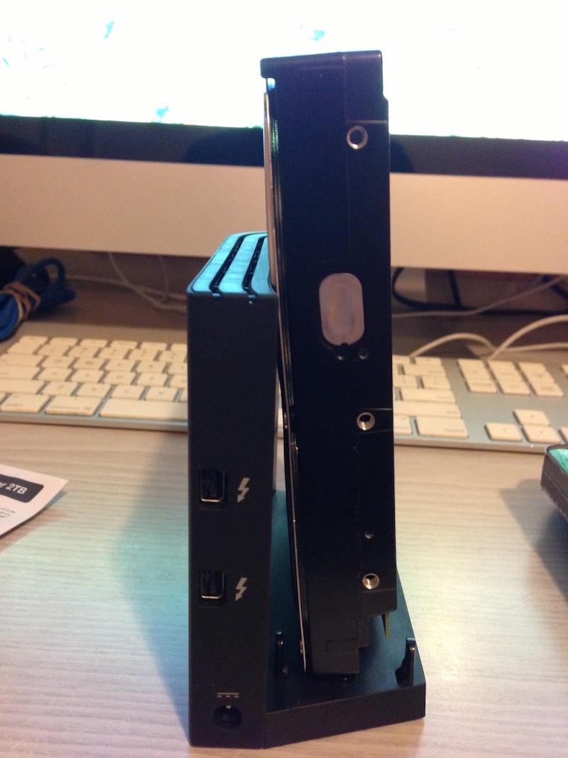

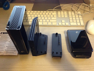

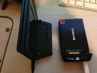

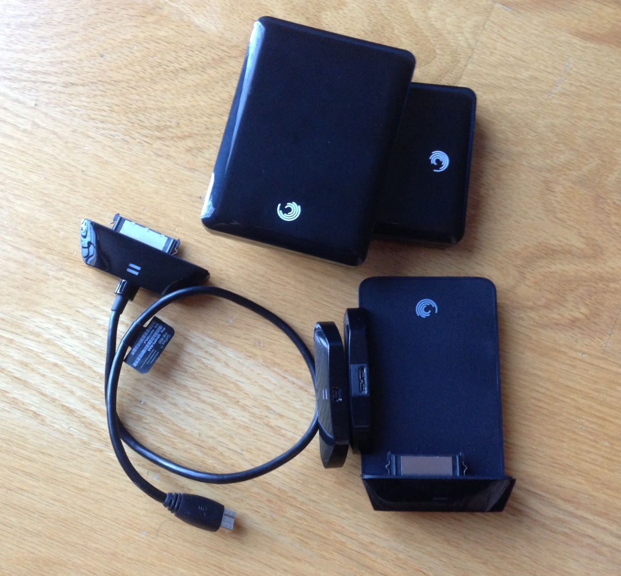

    If you want any form of cross-compatibility and future upgrades, look no further than Seagate's backup plus lines (formmerly go-flex).
    These drive enclosures come with interchaneagle dock connectors. They come standard with USB 3.0 now. They have eSATA, Firewire, USB 2.0 and Thunderbolt adapters. Since they are standard SATA connectors, these adapters will even work with other drives.
    Future compatibility is a big deal.. I've been using these when they were USB 2.0. I upgraded to FW, then now to Thunderbolt. When they have Thunderbolt 2.0 with 20 Gbp/s, Seagate will probably make newer Tbolt version 2.0 adapters.
    In either 2.5 portable or 3.5" desktop. You will need to buy an adapter but that is a one time purchase.
    The backup plus comes right off the bat with USB 3.0. Decide if you want to go portable or desktop. The portable firewire adapter is $89.The desktop is $150. Once you buy the adapter, you can even plug in third party drives.
    The desktop one allows you to daisy chain which is cool.
    Here are all of them. Desktop Thunderbolt adaper, USB 3.0 desktop and 2.5" portable thunderbolt.
    [​IMG]
    The portable one uses a standard USM case. YOu can buy third party USM enclosures.
    [​IMG]
    [​IMG]
    Here is a SSD connected to a portable adapter.
    [​IMG]
    Desktop adapter with standard 3TB 7200 drive
    [​IMG]
    Desktop adapter with SSD
    [​IMG]
    Desktop adapter, allows for daisy chaining multiple Thunderbolt adapters.
    [​IMG]
    Here is the FW800 adapter for the desktop drives.
    [​IMG]
    Here is the 2.5 w/ USB 2.0 and Firewire 800 adapter ($20 at Best Buy on clearance)
    [​IMG]

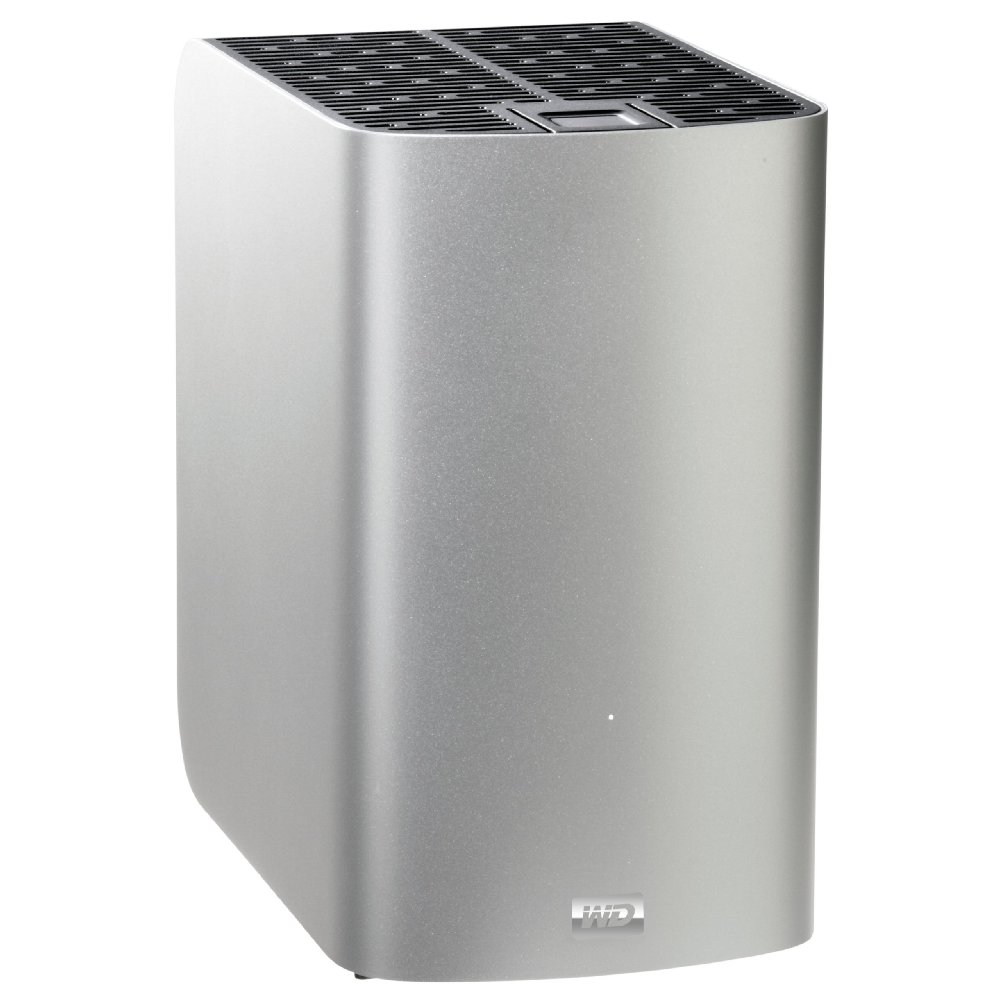

    Have you thought about the Western Digital My Book Thunderbolt Duo? 5400rpm, yes, but it's TWO 5400rpm WD Green drives AND can be set as a striped RAID for better performance. I have the My Book Studio II (same thing, but Firewire 800) and it's plenty quick. Now I'm gonna have to benchmark it when I get home lol... (mine won't be as fast, though - mine's set as a mirrored RAID)
    http://www.wdc.com/en/products/products.aspx?id=630
