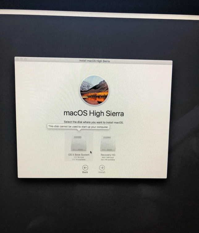

Hi, I keep getting this when attempting to install any OS through the system restore function (not from time machine) just the macs built in reinstall. Does anyone have any ideas on how to fix this, I just want to install any OS at this point!
The "OS X Base System" is NOT your boot drive. It's not much more than a virtual system, used to install OS X. You can't install the system while it is booted to the same system.
The destination disk (that you named) is not visible, which could mean that you erased the drive (not just the boot volume) which THEN means that you have to boot to another installer - either through Internet recovery, or an external bootable installer.
