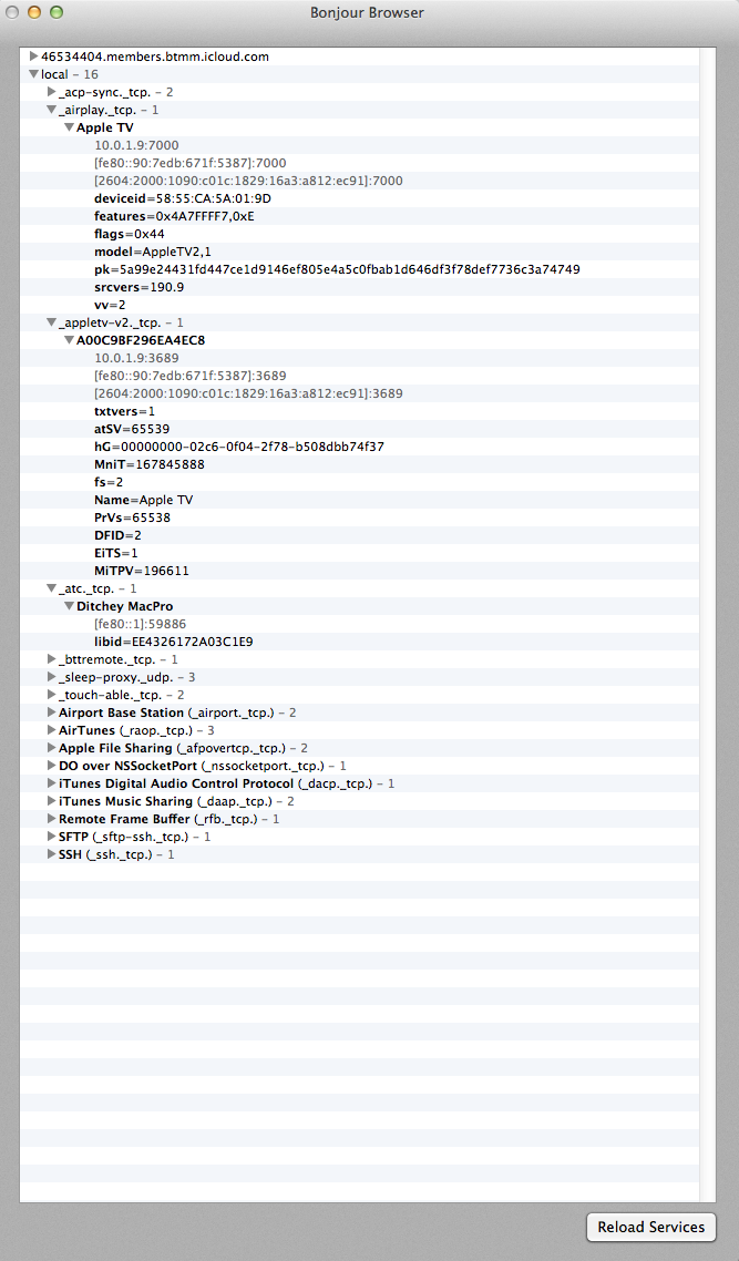

hey,
I tried everything in that list from apple. no change.

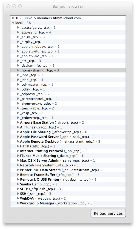

i downloaded bonjour browser, and it comes up with this list... how does it look?

Looks like the very _home-sharing._tcp. is missing.
Check your iTunes account status and HS settings.

What IP addresses do you see, when you expand the following nodes?
_atc._tcp.
_airplay._tcp.
_appletv-v2._tcp.
PS Does your iTunes library have a name assigned?
PPS If you are confident on command line, what do you see when you issue the following commands:

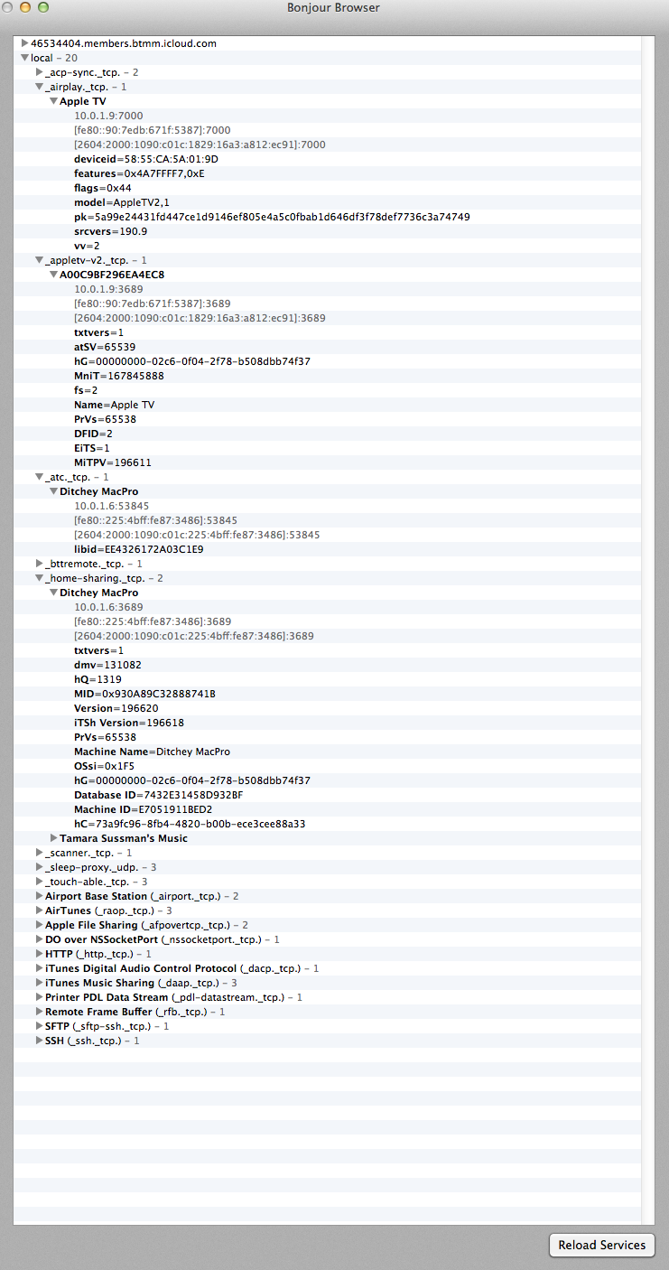

These are the ip addresses from Bonjour Browser...

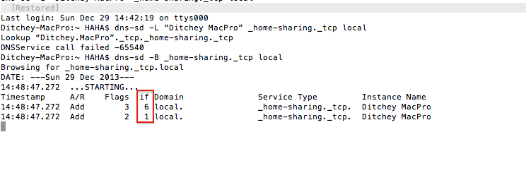

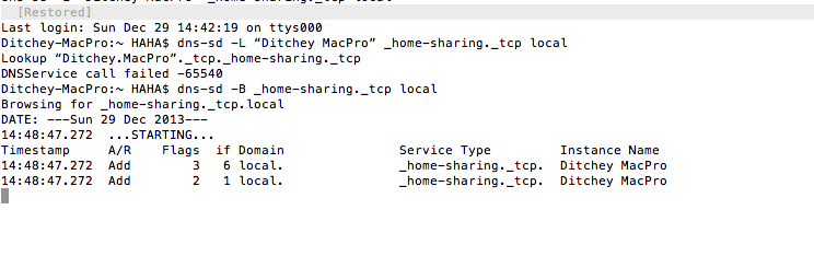

I got to step 2 with the terminal...
The first command i put in was: dns-sd -B _home-sharing._tcp local
and i get the attached results:
but then the next command yields no results: dns-sd -L “Ditchey MacPro” _home-sharing._tcp local
what am i doing wrong?
thanks a million times again..
r.

I immediately see 2 problems (see pics):
1) Your Mac Pro has only a IPv6 address and this is a loopback address (127.0.0.1 in old IPv4 days)
2) Your _home-sharing is registered on 2 different interfaces (#1 and #6). Do you have 2 network adapters simultaneously active?
PS you can see, which interfaces the #1 and #6 are if you run the command in Terminal and count the interfaces (name starts in 1st column and ends with a colon):

Now copy the first and 6th interface descriptions to here.
For example, my Interface 4 that dns-sd reported, happens to be my active AirPort wireless adapter, the en0. I've highlighted the normal-looking IPv4 and IPv6 addresses.

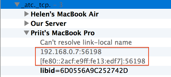

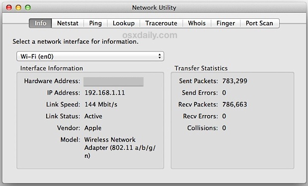

So basically, your Mac Pro is not on your local network with a valid, unique IP address.
You should review your network adapter settings, perhaps using the assistant.
For comparison, I've included a screenshot from my Shared iTunes Library service (_atc._tcp.).
The most blatant case would be simply a failure of your network adapter card or wiring!
I'd have a look at the Info tab in Network Utility first and see through the statii of all network interfaces:

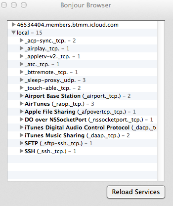

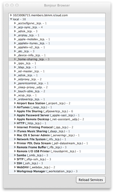

priitv8... YOU ROCK.
i was not able to figure out your instructions, but based on your keen observations i network preferences, and deleted everything but my wifi in the leftmost column... as well as renewing my dhcp license. set my ipv6 to automatic (i had turned it off using the terminal trying to fix this in the past)...
..AND MY APPLE TV CAN NOW ACCESS MY MAC PRO'S VIDEOS!!!!
thank you.
my ipad, however, still cannot. but it can at least SEE the home share. when selecting the home share it just spins and spins.
attached is my current bonjour browser reading... do i still have the same problem? or is my ipad just a bit weak in the home sharing? (it is a first get ipad mini)
thank you so much for your help so far, it is amazing to be able to use my apple tv again.
r.
Glad to hear you can enjoy your media library again!
Try to get a Bonjour Browser view directly from the iPad, using the iOS version of the program!
PS how large is your library? I also see it spin prolonged times occasionally as it tries to buffer the library metadata (incl artwork) on the iOS device.

Machine ID = E7051911BED2
Machine Name = Ditchey MacPro
MID = 0x930A89C32888741B
OSsi = 0x1F5
PrVs = 65538
txtvers = 1
Version = 196620
That one looks normal.
