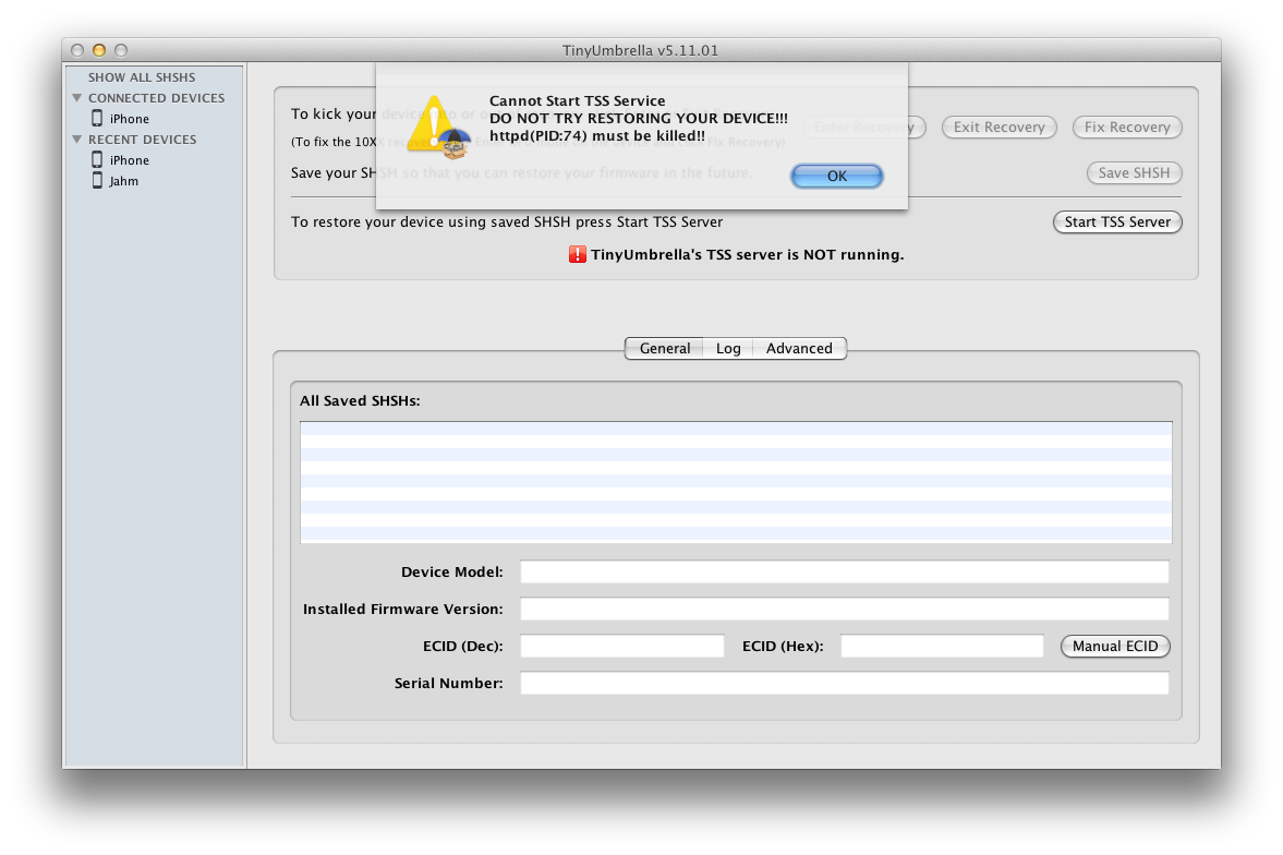

I got this in my logs.
06/08/2012 15:37:35.297 Cannot Start TSS Service DO NOT TRY RESTORING YOUR DEVICE!!! httpd(PID:74) must be killed!!

These are the messages I get right after I started TinyUmbrella. I'm on mac now, btw. I can't check the Set Host to Cydia.

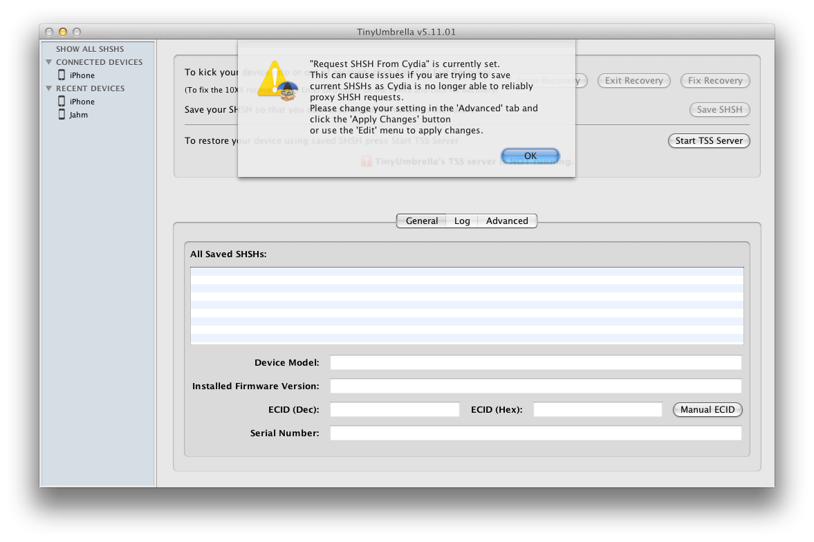

Then this one,
Oops! The image is so huge. Sorry, Idk how to change the resolution.
find PID #74 in your windows process monitor, kill it.
restarting might help as well.
Uncheck request SHSH from cydia
Its an error with other processes working on port 80, try this:
Go to services: Start -> run -> services.msc and look for Apache or any other application that runs on port 80 and stop it.
If that doesnt work, you'll need to consult google.
Try "netstat -aon | findstr LISTEN | findstr ":80"
Kill or disable the service LISTENING on port XX.XX.XX.XX:80
