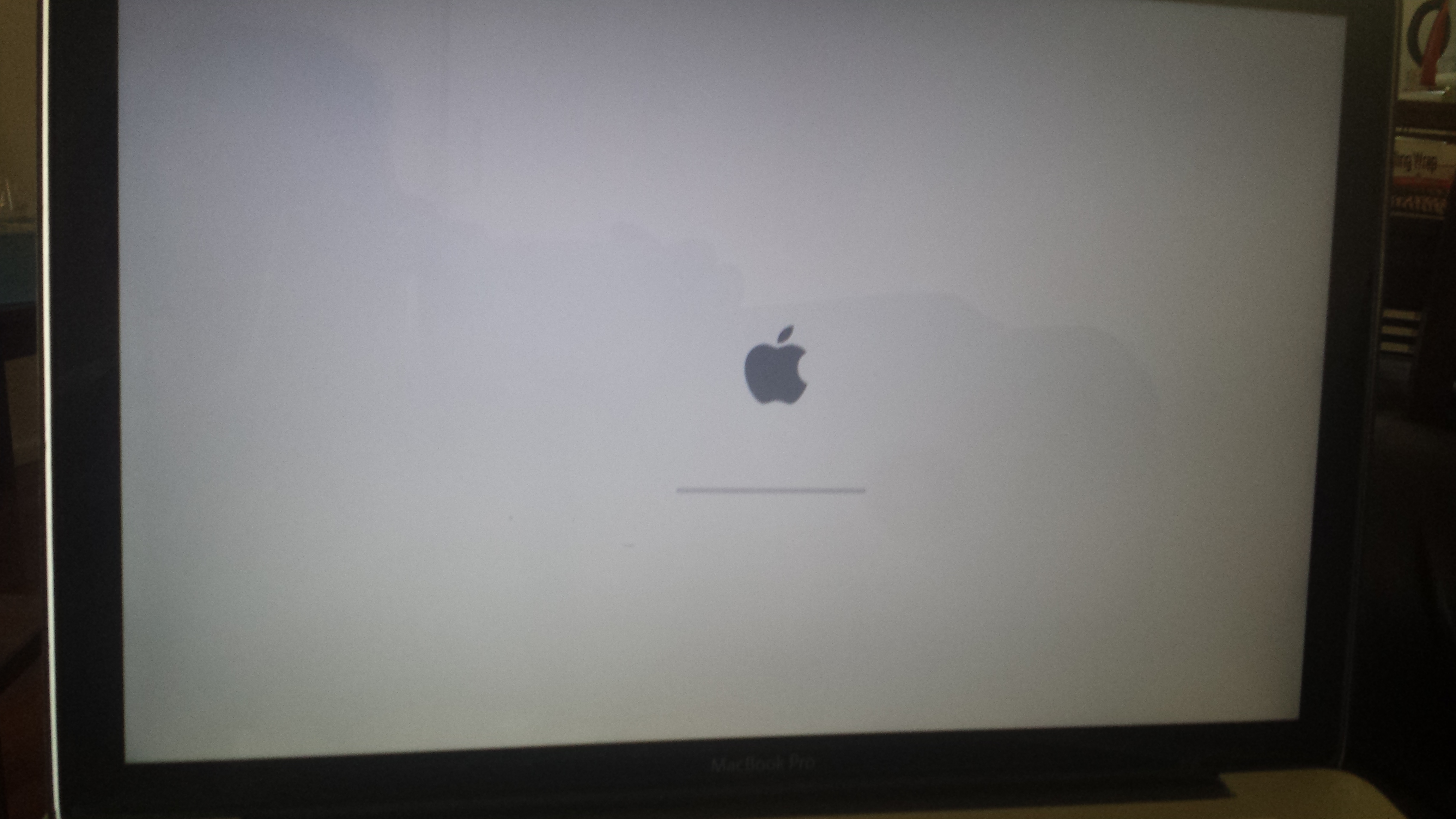

I have upgraded to the latest OSX El Captain in my 2009 mid macbook pro
Everything went well and i was happy with new os, until system reboots
If the system restarts after new software installation, battery drains out or force restart, the booting screen stuck at apple logo phase (grey background) and will not proceed afterwards.
I tried different ways like starting at safe mode - disk utility - repair disk , tried resetting SMC, NVRAM
and no hope
Finally i tried starting on safe mode and reinstall the OS which took almost 4 hours (adsl 2+ connection) to complete and system boot into the desktop as usual. But while installing few apps. the system rebooted and i ended up facing the same issue again (i reinstalled the new os 3 times already).
I have got a new macbook pro 2015 and it works perfectly with new OS X.
Can anyone help me out in resolving this issue

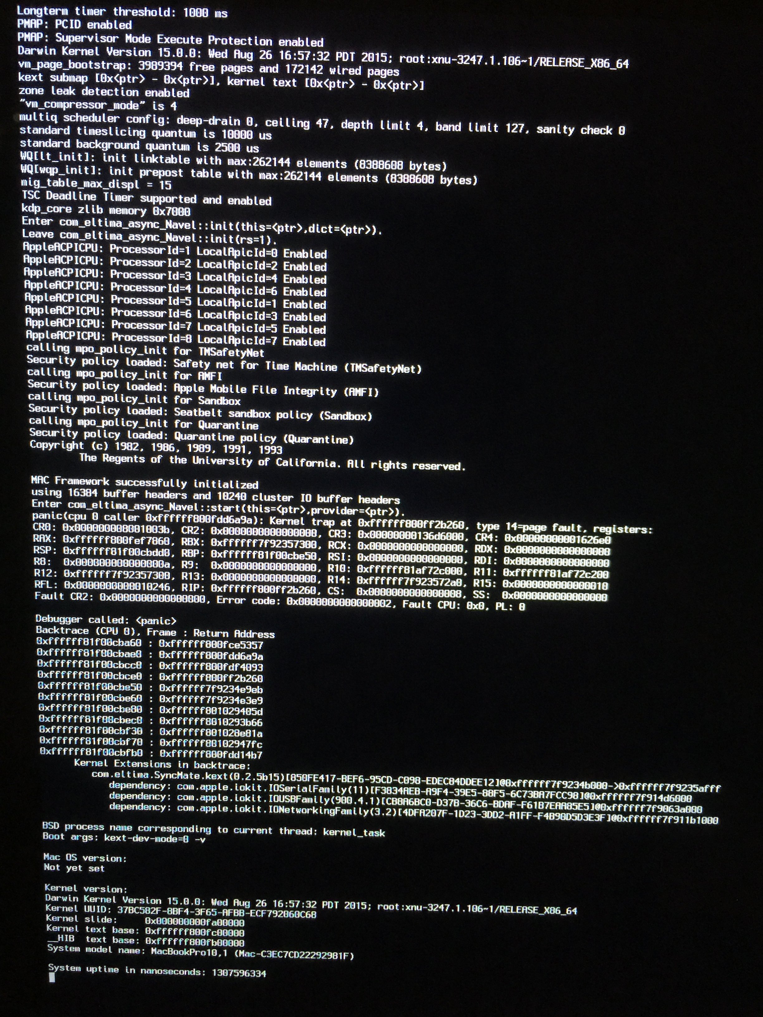

Press cmd-v at the startup. It will show what makes it crash.
To clarify what this user said...
Hold Command + V and turn the machine on. You can usually let go of those keys when OS X starts to boot. Holding these keys will tell OS X to boot in verbose mode, which will detail everything the OS does during boot on the screen. It helps to show you where OS X is hanging and not finishing the boot process.
Perform that, and take a picture of where it hangs. Upload it here. It will help us determine why your OS isn't booting.
Ok that's SyncMate. You have to kill it with fire.
If you know how to use the terminal you can boot from the recovery partition (cmd-r at boot) and delete
System/Library/Extensions/EltimaAsync.kext
Library/Application Support/EltimaSyncMate/SyncMateStarter.app
Library/Application Support/EltimaSyncMate/BackService.app
if not you can restart from an external disk and delete those from the Finder, then restart from the Recovery Partition, and then restart normally.

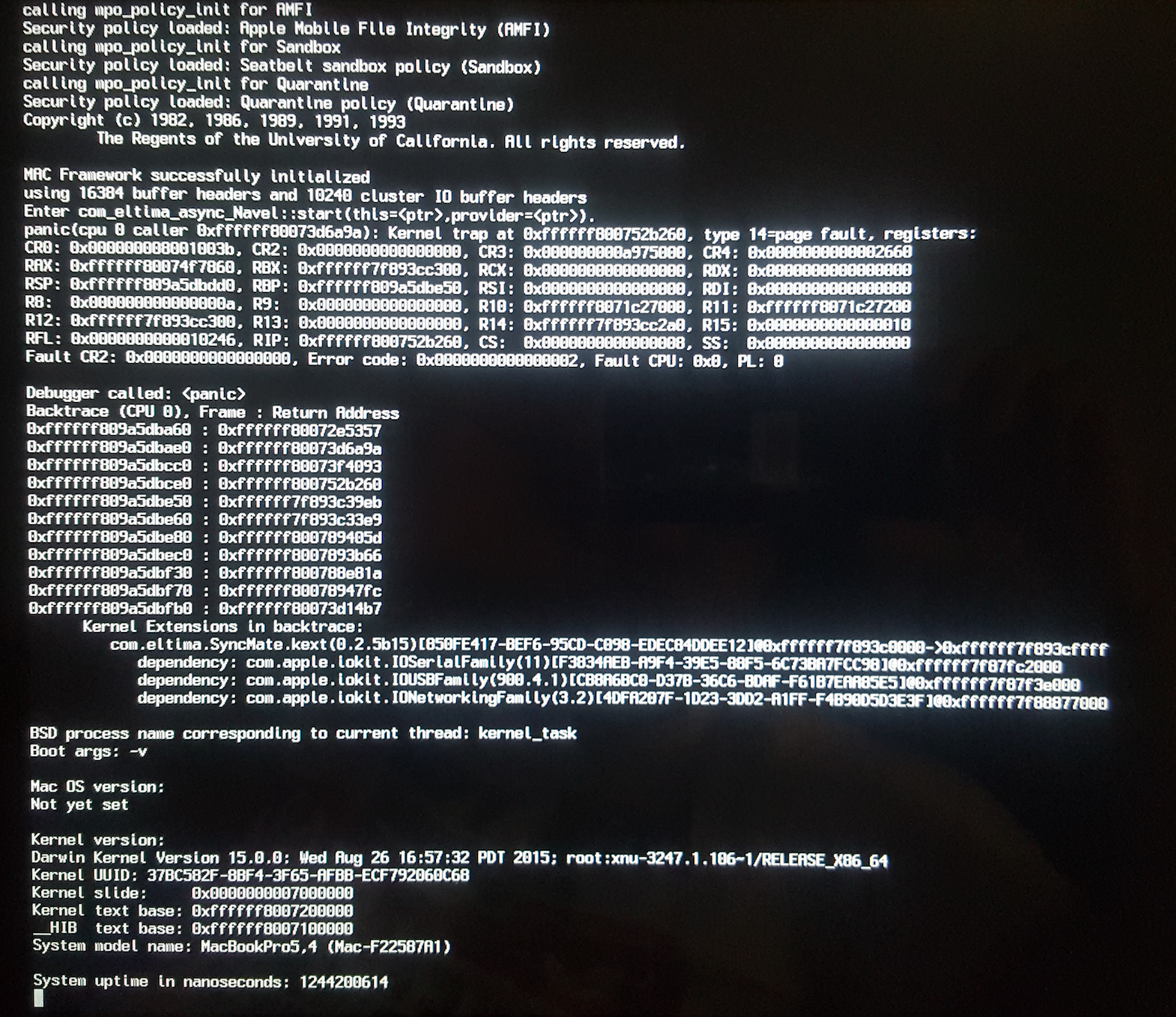

Hi all,
I have the same issue....
stuck while rebooting with el capitan.
please check the pic and tell me how to fix it.
thanks.
Your issue is also syncmate. See the previous post for the fix.

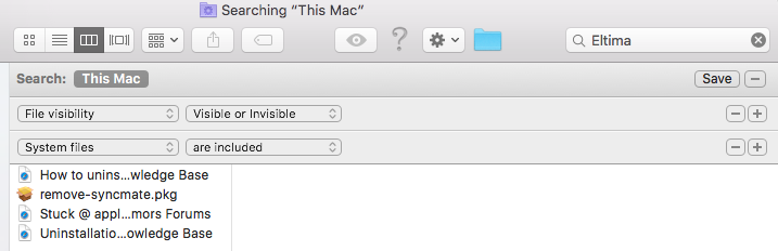

Thanks so much for this post. I had run through all the typical suggestions, e.g., safe mode, Disk Warrior, reinstalled operating system, etc. After hours I finally found this post and it immediately resolved the problem. Thanks!!!!
SyncMate turned out to be the problem for me too. This thread has been extremely helpful. From CMD-V to diagnose the problem to using CMD-R for recovery mode, then using Terminal to find and delete the offending files, this has been a good learning experience.
In Terminal, I entered the following commands to determine where offending files were located, then deleted them using "rm" for files and "rm -rf" for directories.
Code:
cd /
find . -name *Eltima* -print
