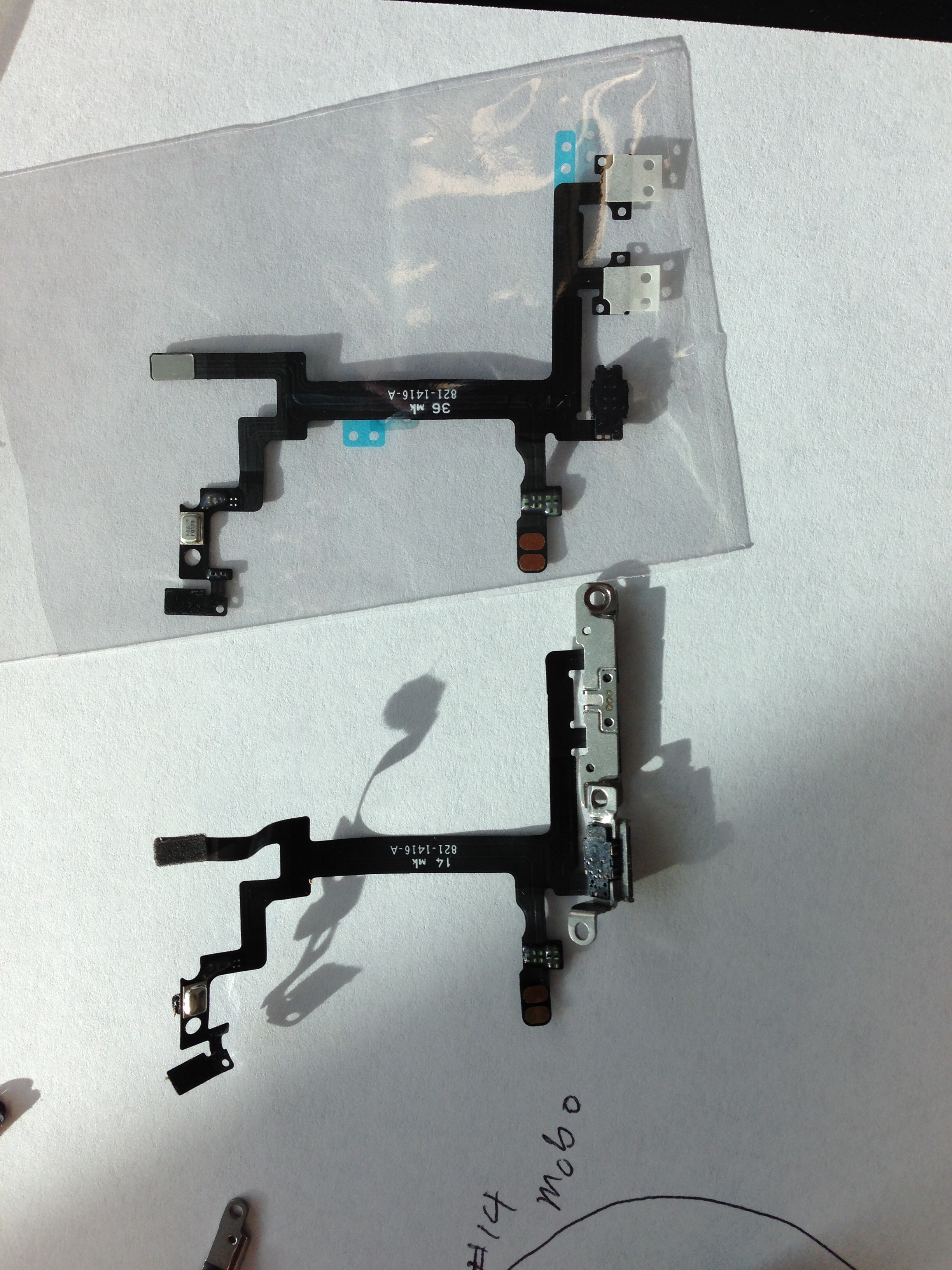

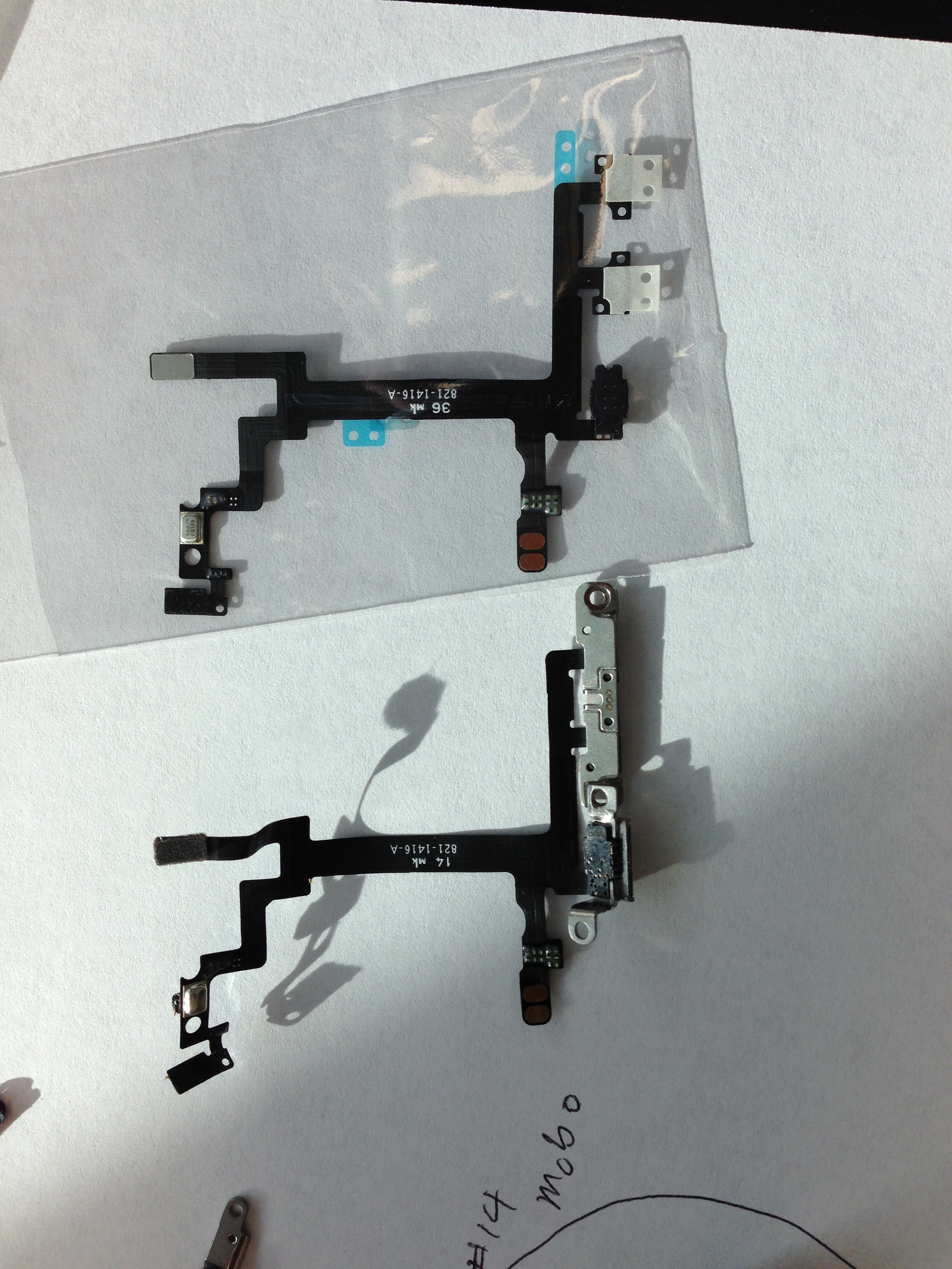

The last couple of sleep/power buttons I've replaced (iPhone 4s and 5), the 4s didn't seem dirty inside, but you couldn't press the button down (there is a point on the flex ribbon that wears away from use) while the 5 had a button that was fully press able and "clicky," but very dirty around the sleep/power button and did not recognize when it was pressed.
The replacement flex button, even if not truly a genuine part, is high quality and can be very difficult to tell apart from the original. Here is a pic of the one from the 5 that I replaced put right beside the replacement (not all parts removed from the defective original). Sent from my iPad.
