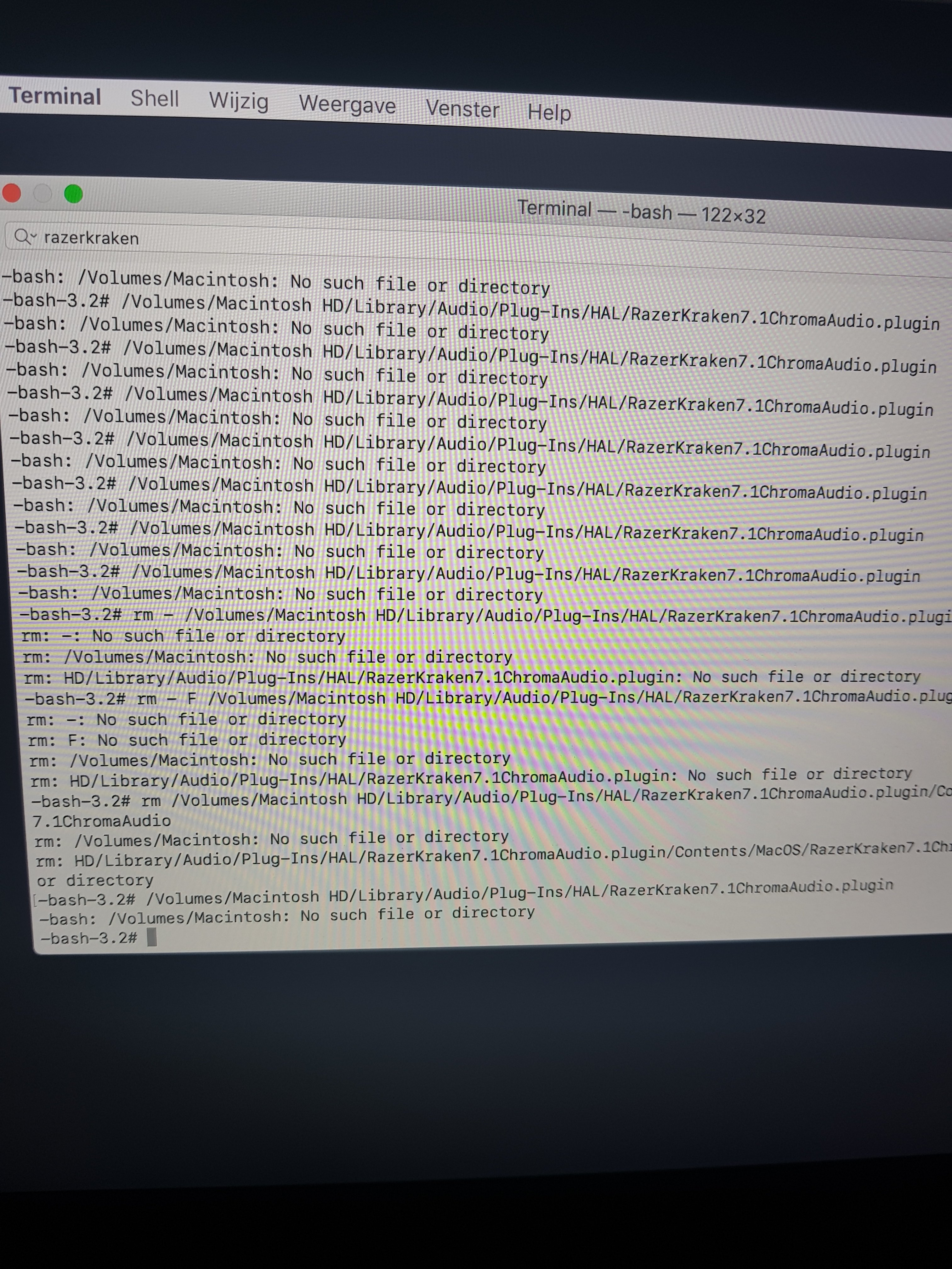

Trying to delete the library but I'm having difficulties. I searched for the correct path but I always get the response the file or directory doesn't exist. Can you spot the mistake?
Make sure that you have used Disk Utility to mount the drive before you try to access it via Terminal. See the other thread for detailed instructions.
