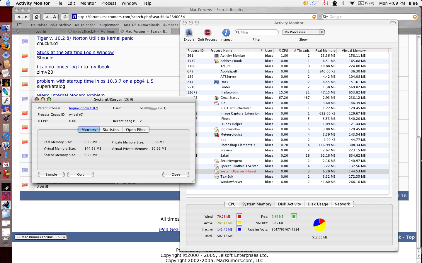

i've had this happen once, it was a horrible pain in my butt to fix because i am not all that "wise" to mac os yet. (i'm learning and loving, just not up to par i guess)
so now that i look at my activity monitor and see another log in window hung, i am scared to even run OnyX (because it will make me restart)
i guess i will have to bite the bullet and try it, but just in case all hell breaks loose and i have to use my windows machine to come back and get help, here is a screenshot

when I reboot, I get no further than the "Starting Windows Login" part...
I had Os 10.3.9 and I updated to 10.4 with the installation dvd
now it works! :apple:
