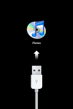

Hey guys, my brother has an iphone 3G, he had 3.1.3 jailbroken and unlocked with T-Mobile and everything was working perfect. He upgraded to 4.2 or 4.2.1 using itunes, then jailbroke using redsnow beta 5 with the ipad firmware 06.15.00 and unlocked with ultrasn0w. And he got that to work fine but the next day he could receive phone calls but not make them. He uninstalled ultrasn0w and reinstalled it and nothing. Finally he wanted a working phone so he tried to Restore his iphone with itunes and now hes stuck in recovery mode (itunes error 1015). I am trying to help him here. I know little about RecBoot and Tiny Umbrella. How can I help him? Can I get him back to 3.1.3 with Tiny Umbrella? Did you even get the option to save SHSH blobs when you were at 3.1.3? Or can I get him to 4.1 even though he was never on 4.1? I just want to get him working, I don't care what firmware but now that hes on 4.2.1 with baseband 06.15.00 stuck in recovery mode I don't know what to do. I would appreciate your help greatly!!! =-(

With the iPad baseband on the iPhone there's no way a clean Restore will ever work on this phone again. Ever. Never.
If you need to restore it you need to restore it with a Custom IPSW. If you google for it I know you'll eventually find one for the 3G that fits the bill

I had this, being stuck in a recovery loop, yesterday. I tried all the tricks and programs on the web but it wouldn't come back out of it
I got it out in the end by using another computer (MacBook) and using the Redsn0w beta with iOS 4.1. I'd tried it previously with the 4.2.1 iOS (the version used to jailbreak it) but that didn't work for me.
I'm not guaranteeing that this will work for you...but for me it did. Above all don't panic, you'll get it back.

3GS? New or old bootrom? Anyhow, since you have the iPad baseband you'll never ever be able to restore your iPhone to anything else but a Custom firmware. With Custom fw I mean one built using PwnageTool (or Sn0wbreeze if that ever becomes available for fw 4.2 that is)
As it is now, you'll never get out Recovery mode. Feed a an appropriate Custom fw to your iPhone using Shift/Option + Restore in iTunes and you should be back on track again

You'll be able to get out of Recovery mode fine, as long as you update your iPhone (still don't know what model/bootrom it is...) with the right IPSW.
Read this and this blog post post several times. I'd like to stress this though - don't do anything unless you feel you know what you do. Ask Ask Ask but only after you've read those links

I have the exact same problem as you right now. 4.2.1 06.15.00 3gs new bootrom stuck in recovery mode. This is lame, I guess we have to wait till pwnage tool gets updated.

PAHtSan and onnightfall my iphone just started working and here are the steps:
1. open redsnow, choose 4.2.1 original firmware, click put into DFU mode, wait till the process is done
2. open iTunes option/shift restore choose the 4.2.1 custom firmware( someone send me this via email i can email it to you ,just PM me your emails)it will restore your phone, at first it will show you emergency call only, leave it like that it will take like a minute and then you will have the normal screen.
I hope it will work for you guys!!
