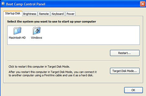

    Have you at least looked at the Control Panel in Windows to see if it "sees" the OS X partition as a startup device?
    [​IMG]
    You can select the startup device from the command line too as described here: http://support.apple.com/kb/HT3802
    Or do you have an Apple remote? You can also hold down Menu during boot if Option doesn't work for one reason or another.
