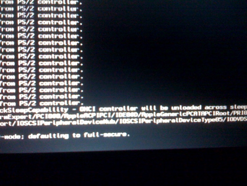

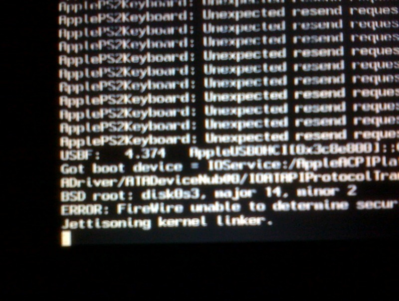

thanks, i dont get "waiting for root device"
this is what i get and it hangs on this.

i just reread your original post and realised you are booting off the dvd. so what is happening is that it's not liking your dvd drive.
the best thing to do is boot off a usb disk, either a thumb drive or a larger external harddrive will do.
also, i did a quick search and while people do have problems, they seem to sort them out ok. though iatkos does not seem to be the preffered distribution these days for AMD, leo4all seems to have better success.
specifically which dv6000 model do you have? you should be able to look on the bottom of your computer. something like dv6123a, etc...

right, so it is your sata controller causing problems.
the easiest is to install off of usb and onto usb.
alternatively, there seems to be a kext that may work, someone mentioned it is included with the leo4all iso.
but this is where you can get around the problem by using usb.
