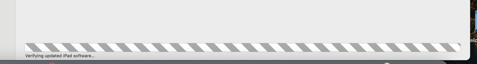

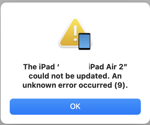

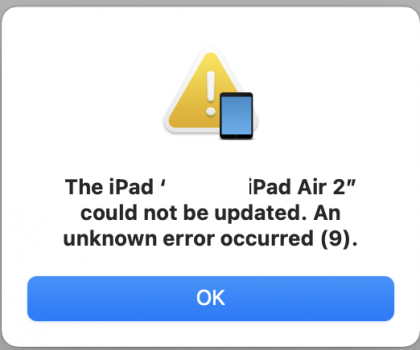

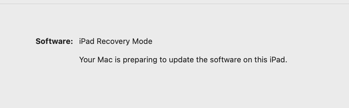

I apologize I think I misread your original post. Are you saying your iPad will update however the only way is via iTunes (now finder)? If you use OTA its freezes at verification?
If so I read your post wrong, I tried doing and update via Finder on my iPad Air 2 and I got an Error 9 and soft bricked it. Its in the process of restoring but its in a infinite boot loop.... 😂🤣😂🤣
