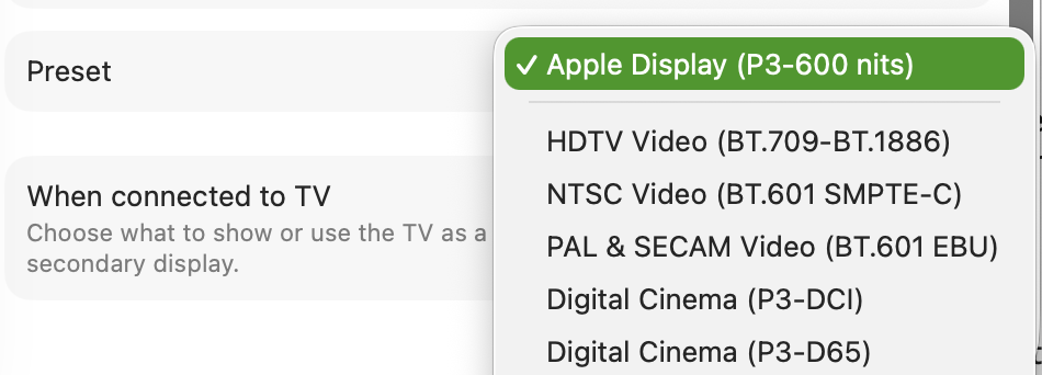

Hello,
Have you checked the display Preset menu under System Settings > Displays?
If there is a different preset is active, not Apple Display, Brightness control stops working.
