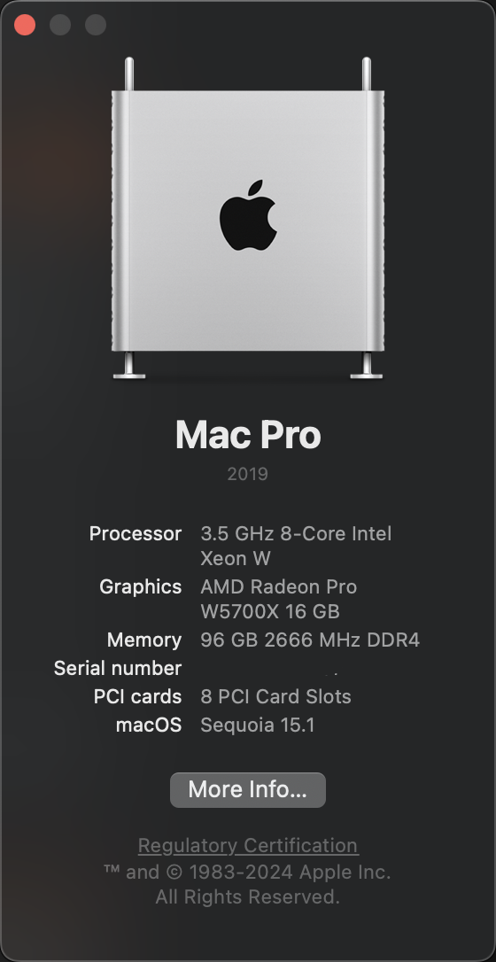

Maybe it‘s the combination Mac Pro 2019 (7,1), W5700X and Apple Studio Display (Firmware 17.0) - Does anybody have a similar setup here and running at least macOS Sonoma and up?
