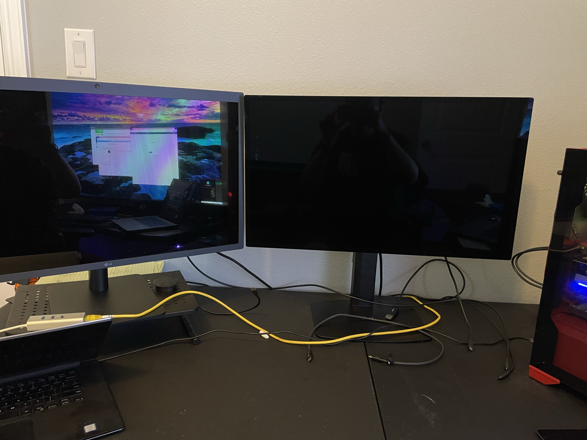

I just recently got a studio display with the vesa mount. Since I currently work mostly on Windows, the display has been mostly attached to my PC.
I connected it to an AMD PC using the thunderbolt titan ridge add in controller card. Initially, I had to disconnect one DisplayPort from the titan ridge because I would not get a display output when both DisplayPort inputs from the add-in card were connected to my GPU. I don't know if this is because I am using an Nvidia card.
I then tried connecting the studio display using a USB-C cable and that too worked. I was then able to connect my LG 5K display. I also had to use a USB-C cable instead of a thunderbolt cable or the the studio display would go blank. I think this confirms that the Studio display can do DSC to achieve 5k 60Hz on a single DisplayPort connection. The LG 5K is currently outputting 4k only. I cannot get it to display 5K at 38 Hz like I had done previously. I changed video cards from AMD to Nvidia and the Nvidia card will not let me do a custom resolution.
I might try switching back to the AMD card and see if I can get both displays to output 5K from one thunderbolt card.
The Studio display looks very good, but I am having issues with the microphone and the speakers. I was on video calls and the microphone would stop working and I was hearing distortion from the speakers. This could maybe be caused by the fact the display is connected with a usb-c cable. I don't know, but it was very annoying.
I also don't like how the highs sound from the display. I actually like the speakers from the LG 5k better.
As for the webcam, I thought it was ok. I looked better on it, but then I was previously using a Logitech C615 webcam so I didn't have a very high bar.
I did not figure out a way to control the brightness from windows. For the LG 5K, I use a an app called LG UltraFine brightness to control the brightness. It did not work on the studio display. I was able to change the brightness on my MacBook Pro and then it retained the setting when switching back to the PC.
I am probably returning the studio display. I don't really care for the speakers and the webcam and the display is just too small for me.
Here is a pic. Excuse all the cables, since I was experimenting with them. I do like the look of the studio display a lot better than the LG 5K.
