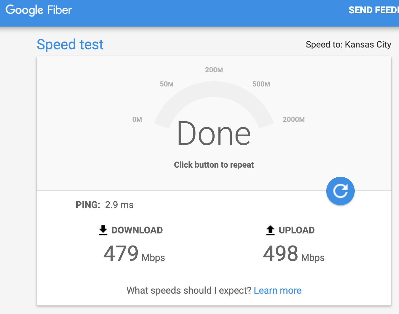

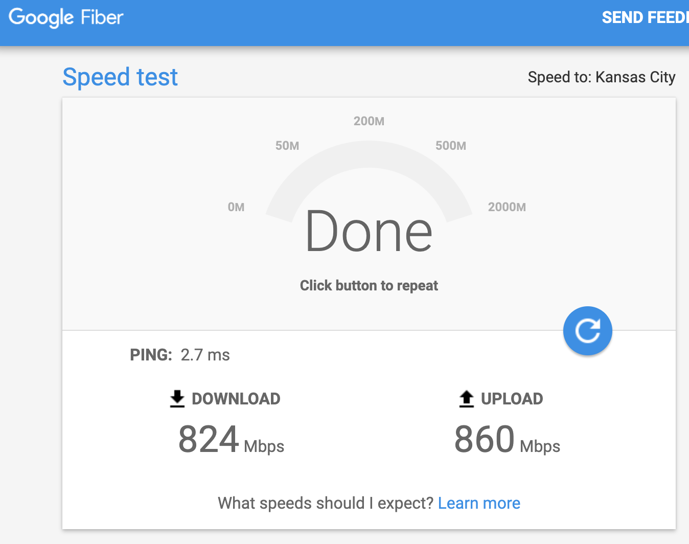

I have the same numbers with the Belkin 1Gb USB-C adapter. I ran the test several times each with similar results.
Doing the testing during working hours, so the throughout on the fiber is slightly slower than usual.
Connected directly to my MacBook Pro:
Connected through the Studio Display:
