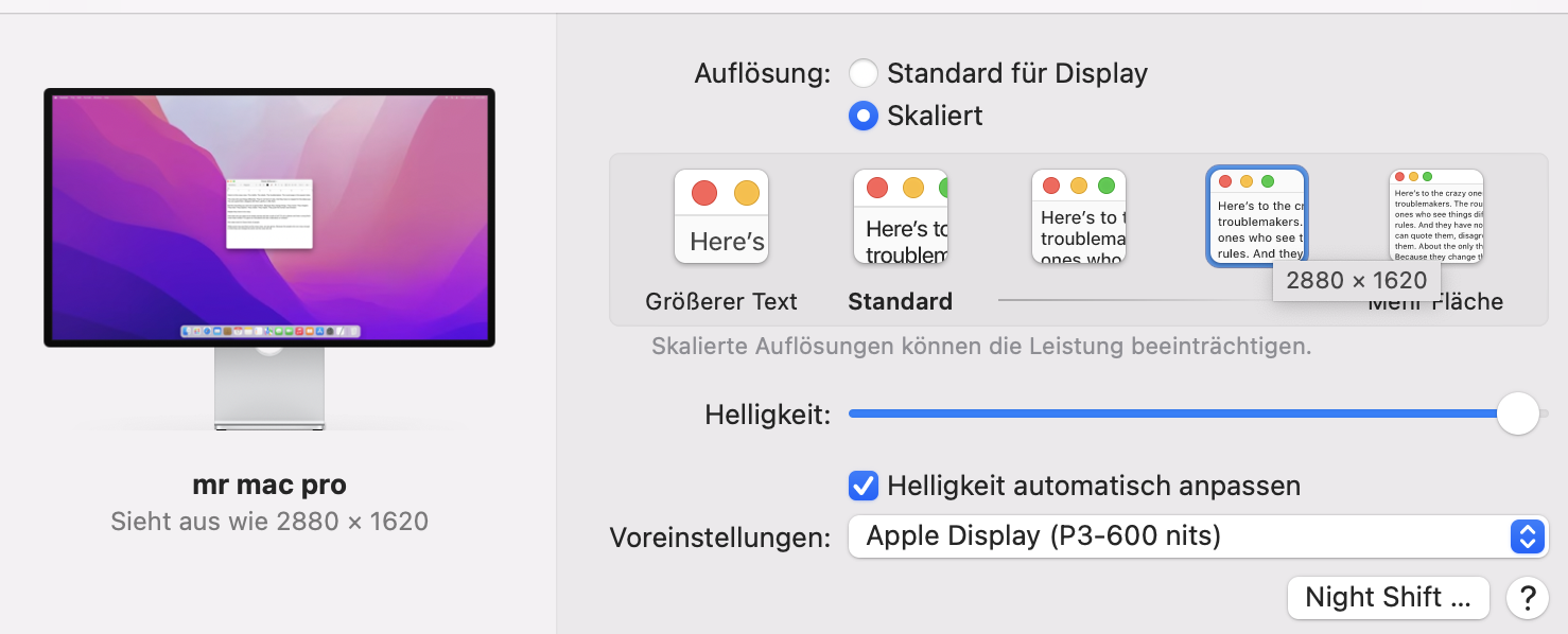

Hey I am connecting the Display with the original Apple Thunderbolt 3 (USB‑C) auf Thunderbolt 2 Adapter. I the best choice?
I am running it now on 2880x1620 is the the best resolution? I am using that menu. Or are there hidden features like HZ and other resolutions?

awww nebie question how can i check that? is it 5120 x 2880?
i think i can set up about 3800 or so
The highest is 3200x1800 ist nearly 4K right? Is there a hack or work around to push it to 5K and or activate the camera? With a other adapter or something. Normal somebody of the community starts pogromming something
Sorry what does that mean?
It means even though you have a 5K 60 Hz display (Apple Studio Display), your 2013 Mac Pro only has Thunderbolt 2, which does not have the bandwidth to support a 5K display over Thunderbolt. You are limited to 1x 4K display @ 60 Hz (Apple Studio Display but only 4K @ 60 Hz) or 2x 2K displays @ 60 Hz (Apple Thunderbolt Display). Mac Pro 2013 only supports 5K displays which support dual-DisplayPort cable (which aren't manufactured any more because single-cable Thunderbolt 3 .. Apple Studio Display.. is current technology). You have to purchase a used dual-DisplayPort cable supported 5K display to get 5K out of the 2013 Mac Pro. Something like this...

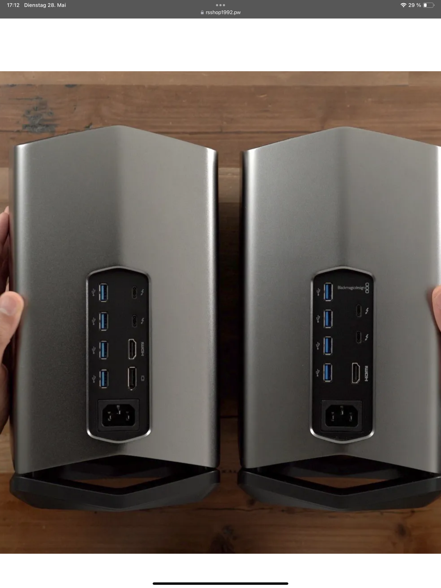

Actually, there is something you can do. You should be able to run your new Apple display via an external eGPU. You can find most information about how to set up an eGPU on this link below:
Most of your questions will be answered in this specific question.
Now most people drank the Apple Cool-Aid and will tell you, TB2 is not bandwidth. But its not entirely true if you work with the right setup. The real problem is not really the bandwidth, its Apple Software that does not permit it or Apple that does not want you to use the eGPU. According to my research there is a big difference between the "Apple-blessed" eGPU's and the Non-Apple-blessed ones.
Since this whole eGPU Hype is already gone and prices are very low, you may want to consider to go the Apple blessed route. This is mainly either a BlackMagic eGPU (RX580 or Vega56) or the Sonnet Puck systems (RX5500 or RX5700).
According to my sources, the Apple Software problem is more severe than the bandwidth problem.
Since the Vega56 is different and has a regular Display port compared to the smaller version, I would advise to either go with the Vega56 or with a Sonnet Puck version. The Sonnet most likely will be a bit faster because its newer. But I am sure the Vega would look nice besides a 2013 MP6.1. It would be best to do some research for people that have this exact setup and see if you can ask them how it worked for them. The mentioned cable above is very important. I think those are the tow ingredients that will work best. An Apple blessed eGPU and the cable from BigWaffle.

Regarding that camera, - this is another example of Apple software (and it’s walled garden) that doesn’t permit you to use it “In the Name of programmed Product obsolescence“.
What I would try is this:
See if you can reach out to Sonnet & OWC / Calldigit … customer support and ask them if the Apple software lock can be removed if you plug in your TB3 cable from your Apple Studio Display into their Dock first and then to your MP6.1. This might help, because a dock can usually split all signals into its separate ones(Video, Data & Audio). Maybe also a simple dongle or adapter can do the trick.
I’d take your MP to an Apple Genius Bar or better an Apple Premium reseller (Gravis) to try out different docks and dongles to see which one disable that Apple software requirement.
Another thing to mention on the eGPU is this. Keep in mind that you always need to use the eGPU (in-line) between your MP and your display. This way it forces MacOS to utilize it. If you just use the eGPU parallel, your benefit will nbe next to nothing. That’s also the reason why only the Vega56 might work compared to the cheaper version, because it works like a dock.
