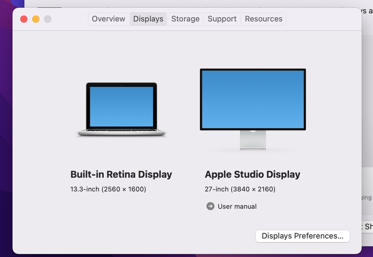

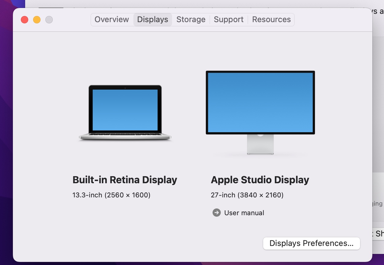

I can confirm the Studio Display works great at 4K with my 2015 13" Retina MacBook Pro. I'm using the Apple TB2-TB3 adapter and a Belkin TB2 cable.
Woah... so to confirm, the Studio Display WILL work with my mid-2015 Macbook Pro?
I just assumed it wouldn't. Awesome news.
Looks like it'll run as a 4K monitor and not 5K according to BeatCrazy's screenshot.
