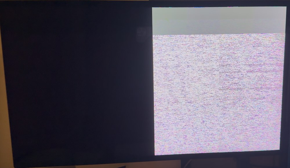

@thenewepic "I also don't believe the issue is related to "dual-pipe operation" (whatever it is)..."
That's the Kernal Panic report:
Quote:
"DCPEXT1 PANIC — apt firmware : dual_pipe.c:180 sync_pipe_end_of_config()-- - iomfb_mailbox (71)..."
"The crash is in the Display Coprocessor (DCP) firmware running on the RTKit RTOS — specifically in the dual-pipe synchronisation code path.
The 5K panel at 120Hz requires the DCP to split the display into two pipes, and the sync between them fails.
The faulting task is always task 71 (iomfb_mailbox)."
